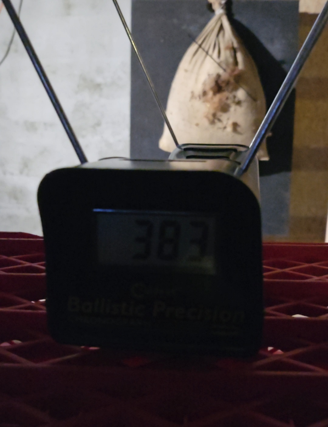

383fps/205gn, 105# bow

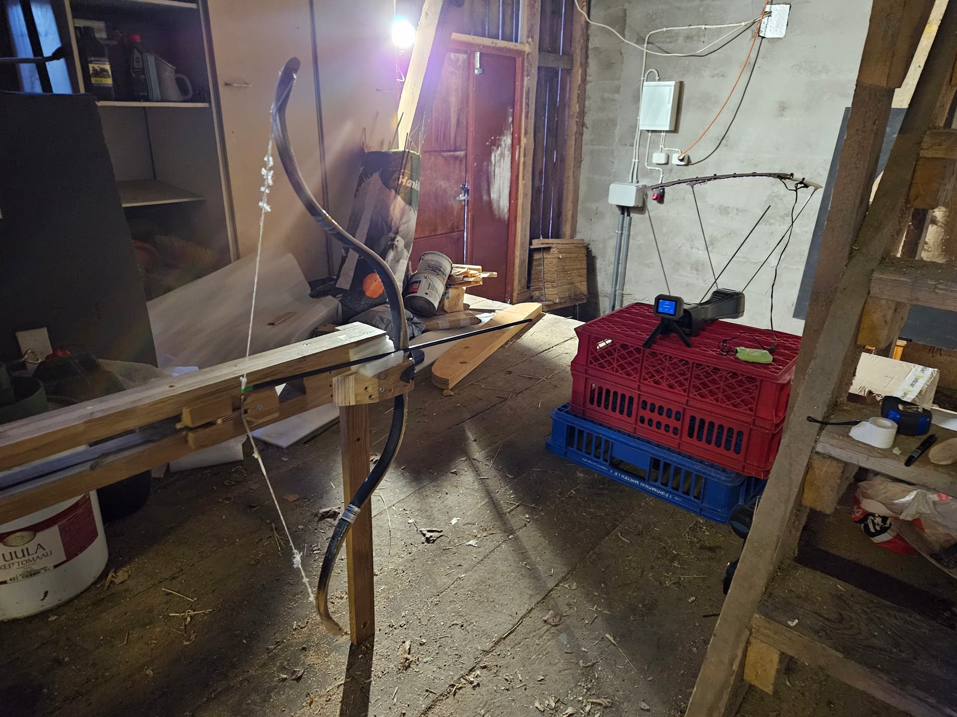

I did some chrono testing of bows. Best out of all was this “surplus bow”. Patched up and beaten with heat, delaminations and so on. It just goes to show very little is needed.

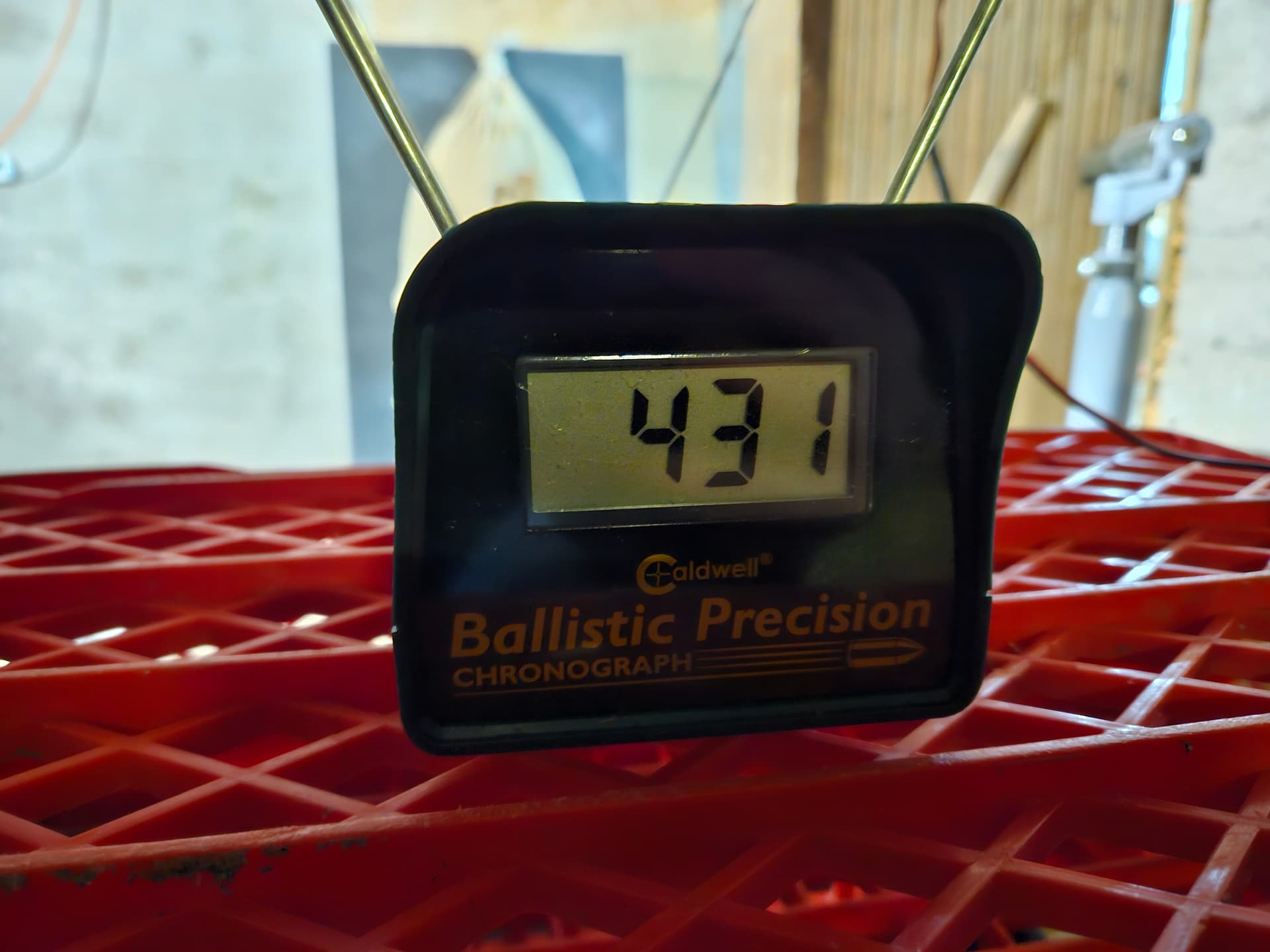

383fps with 205gn and 431fps with 150gn.
150gn arrow mass is not realistic in wood world, but with carbon arrows it was funny to test. 200gn in the other hand is completely possible. Maybe 220gn would be better though.

This bow would have done 388fps with 200gn arrow. I calculated 5gn = 5fps, which seems close to reality by experience.

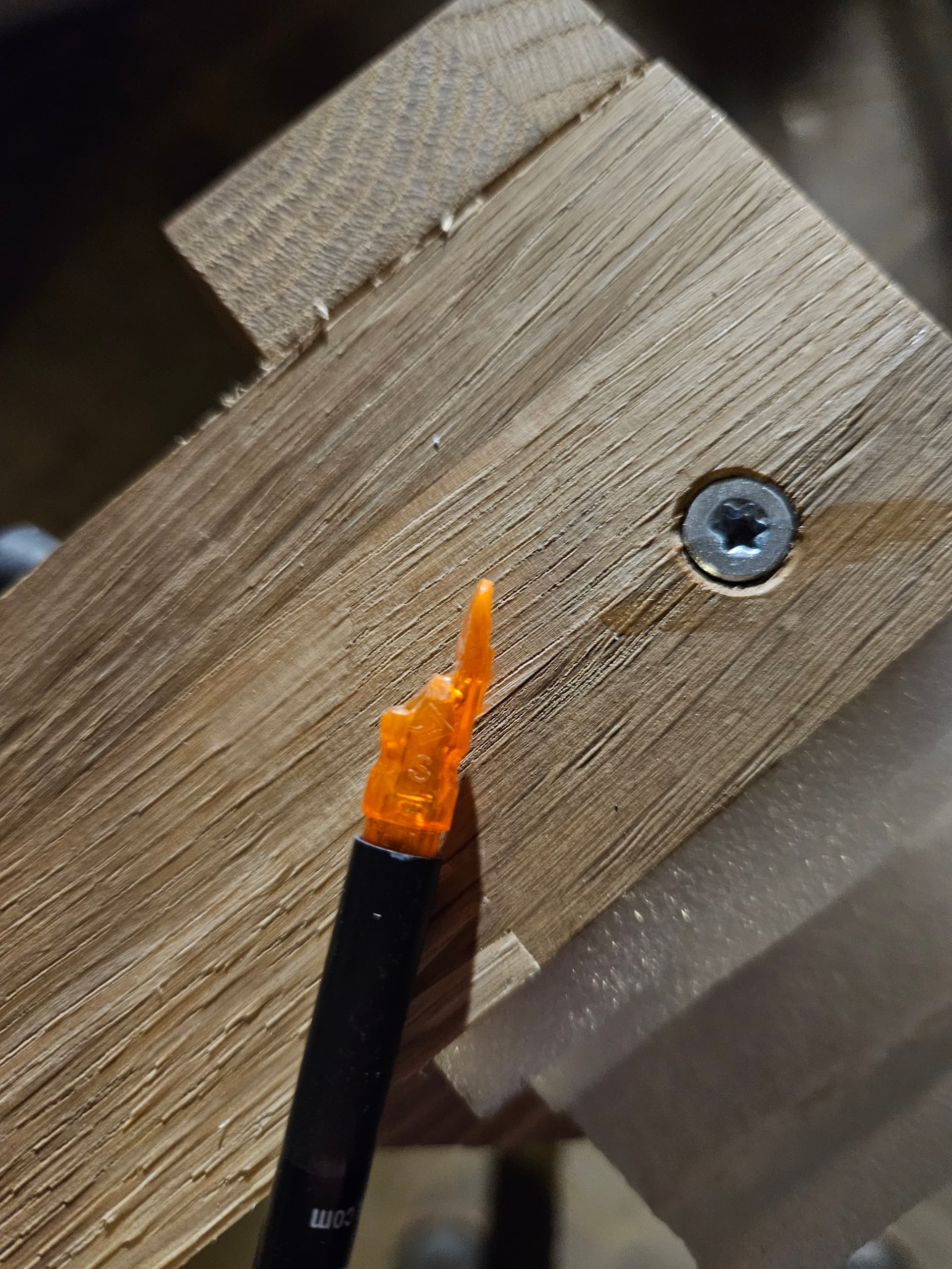

Unfortunately this bow broke a plastic nock from the chrono carbon arrow and broke from the top limb! Really, really unfortunate and makes me a bit scared to do any other tests with plastic nocks in the future. This was the reason i didn’t test any new bows - which actually seemed more elastic and better suited for good speeds. I made a aluminium nock for testing already, so i will use that next time.

Those plastic nocks look to be too fragile and dangerous really.I never use them even on my bows.

I once thought putting a horn insert would be enough in self nocks.I was mistaken as horn does have grain like wood also.A wrapping IMO is needed also with this style.
The turk arrow nock construction is probably the best example of durability for it’s sport.Or some sort of horn dowel inserted length into shaft butted against the end of the shaft.
Still needing wrapping to finalize the construction.
Time consuming to say the least.
Well we did manage to shoot these same nocks with a 138# bow earlier! But i agree, its risking too much.
Sure, but the point of shooting machine is to get rid of the human-factor. We want to test the equipment and evaluate its performance. I would prefer to test all of the bows i make but it takes time and setting up the chrono…
