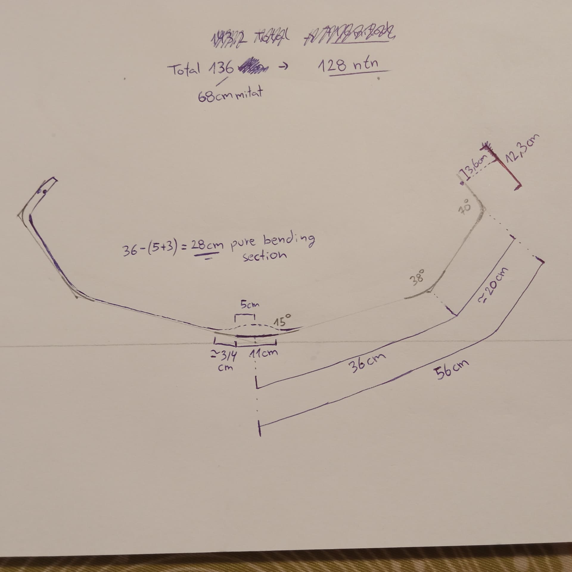

do you have a template or meassures for the Crimean forms? I want to bend some greenwood for next year
I’m planning to draw some template and share it with measures here.

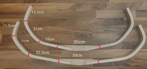

What i find important is agressive tip bend and enough long tip. This one here is about ok. Tip is 11,5cm measured from the very end to the apex of the tip bend. It gives approx 8-9cm long tip measured from the nock groove. Because it would be nice to have some overhang there, 2-3cm.
The maple lath is 64cm long here.

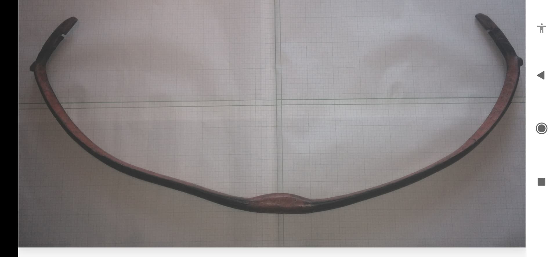

I have read the article writren by one of our firends from Hornbowyers, I am sorry do not remember the name. There was dimentions since the man went to the museum and published the article.
Do you agree with my interpretation? What about the angles? I am planning one Crimean with less reflex syha angle. About 50 degree angle

I have some forms, but not right now accessable. I have pictures of my tatar bows here and i can pull up some more pictures. What i would do is start out with thin maple - not more than 15mm thick. And try to bend the tip a bit over the target because of spring-back. You might want more smooth bends in tip and kasan. Now the angles are really abrupt if you compare to the old bow. Its curves are more subtle.
Then have quite short kasan and longer bending section (sal). That way you will have more manageable stresses with the reflex grip.
