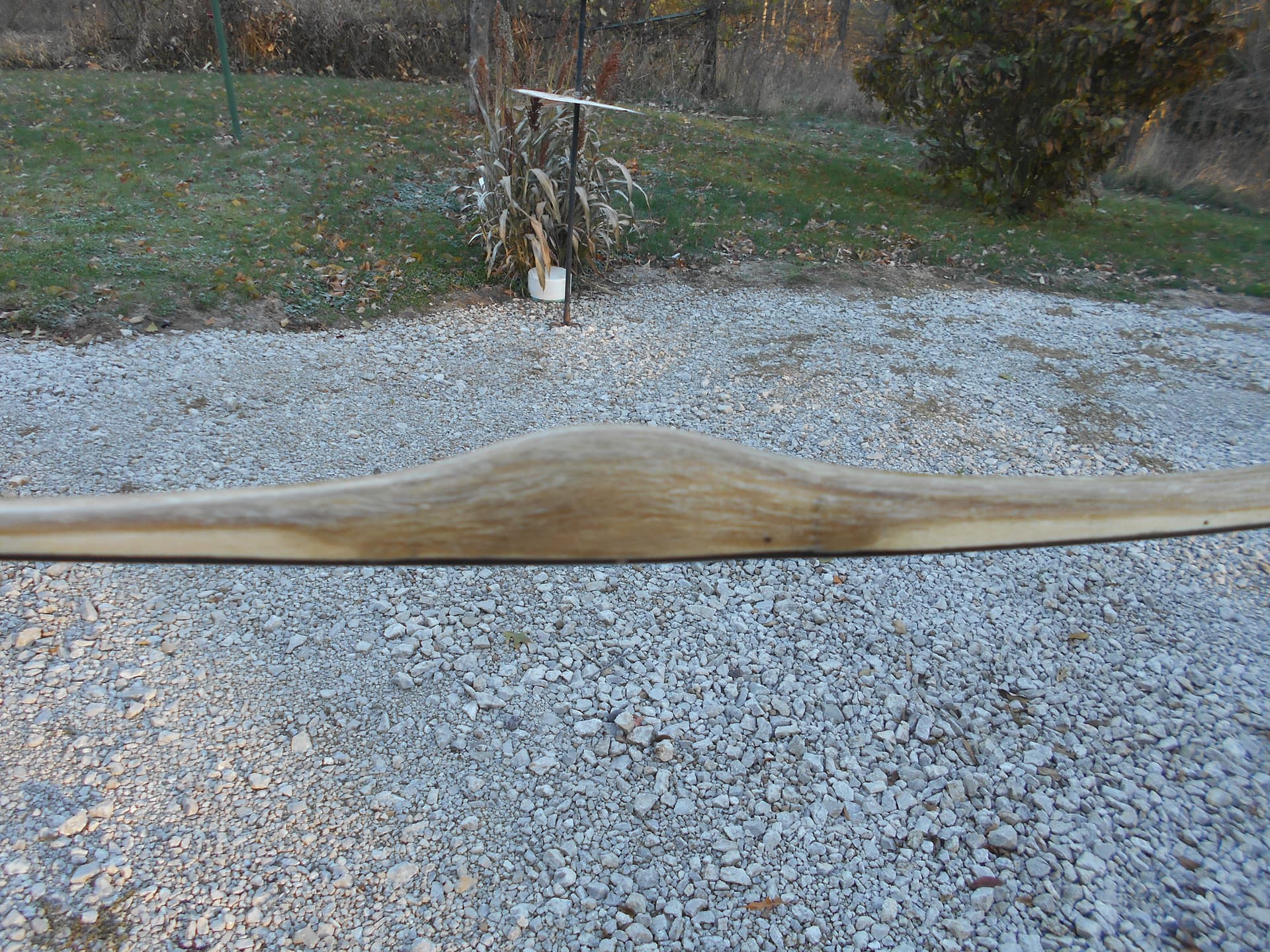

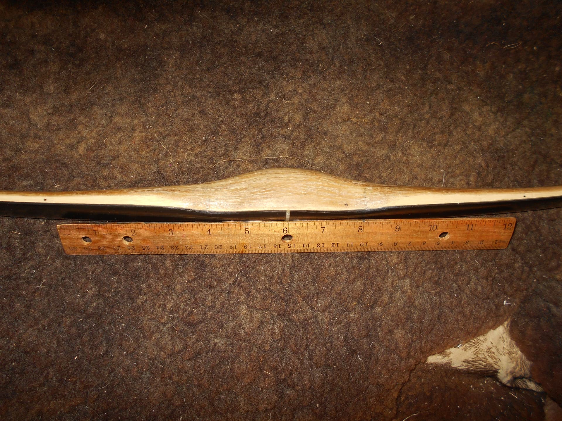

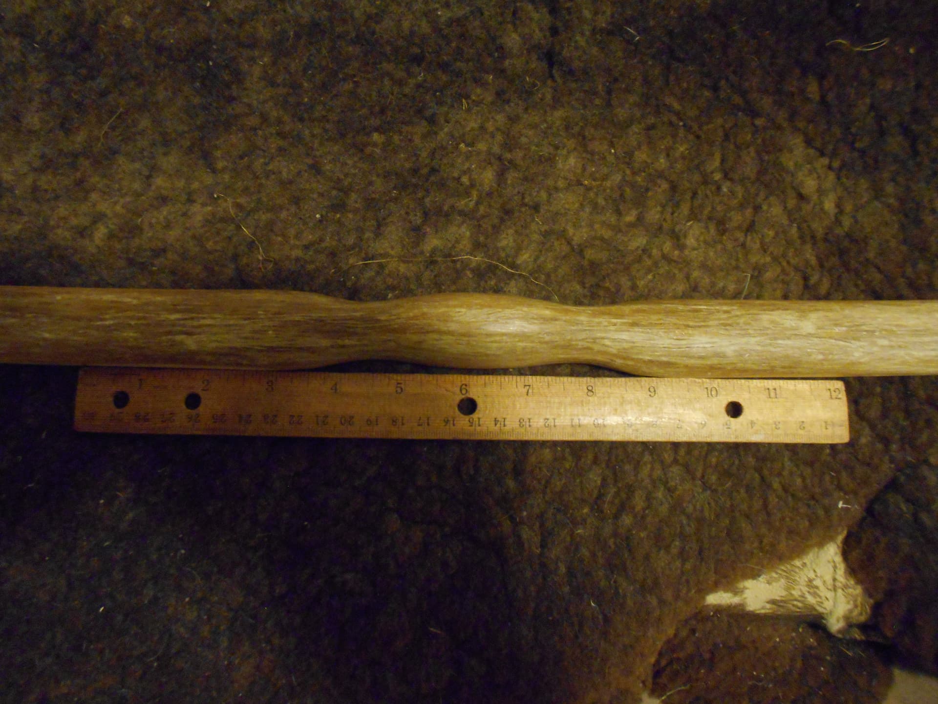

I have this bow within a few weeks of tillering.Handle overall is 1 foot long including fades.V splice type.My question is about the security of the handle fade while tillering.Overall thickness at fade is 14 MM…4MM of horn/4MM of sinew/and6 MM of wood core.
Should this hold up when flattening the bow on the peg board?Or will it need some sinew wrapping?I much rather like the cleaner no wrapping look myself.I’m not sure sinew wrapping would be enough anyway to make any difference.
Sinew runs along side the handle over the splice,but not along the limbs with this bow.Is that secure enough also?
Being a hunting bow of 50#'s or less I feel it will not be all that stressed.
To me it looks really secure!

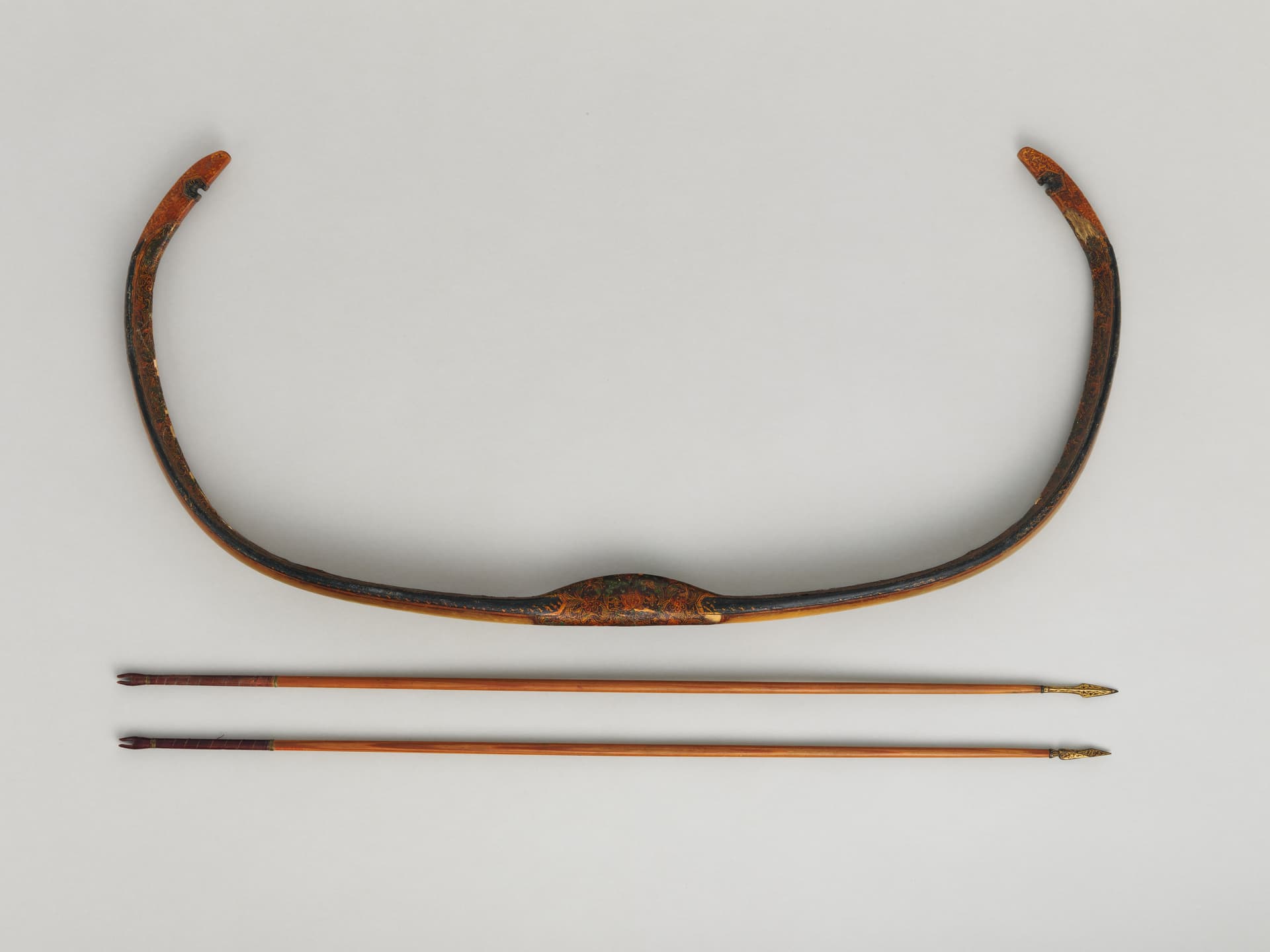

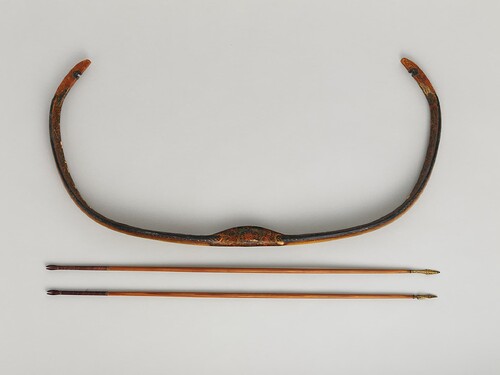

Original turkish bows have quite steep taper around the handle and that also works. Like this bow here from new york Met museum:
One important thing with the handle tapering is to make sure there is enough thickness at the arrow pass area, which you do. If this is overlooked, then there would be quite excessive bending.
Thanks for the oversee…It should hold up ok then…Anyone sqweemish about breaking bows has not made enough of them I figure.
I try to form fit my handles to my hand while shaping with a feeling of control of the bow,but not overly much to torque in any way.Just a rocking motion in the hand more or less.
The forward handled constructed overall bow weight is well over an ounce less [closer to 2 ounces] than any conventional handled bow.Not all the loss where it’s important but still to a degree.
I can’t claim any name for this type bow,but just know that they perform in the parameters that I like and are pleasant to use and shoot.56.5" NTN.
The thickness of arrow pass I like around 20 to 22 MM which usually always holds up for me.
