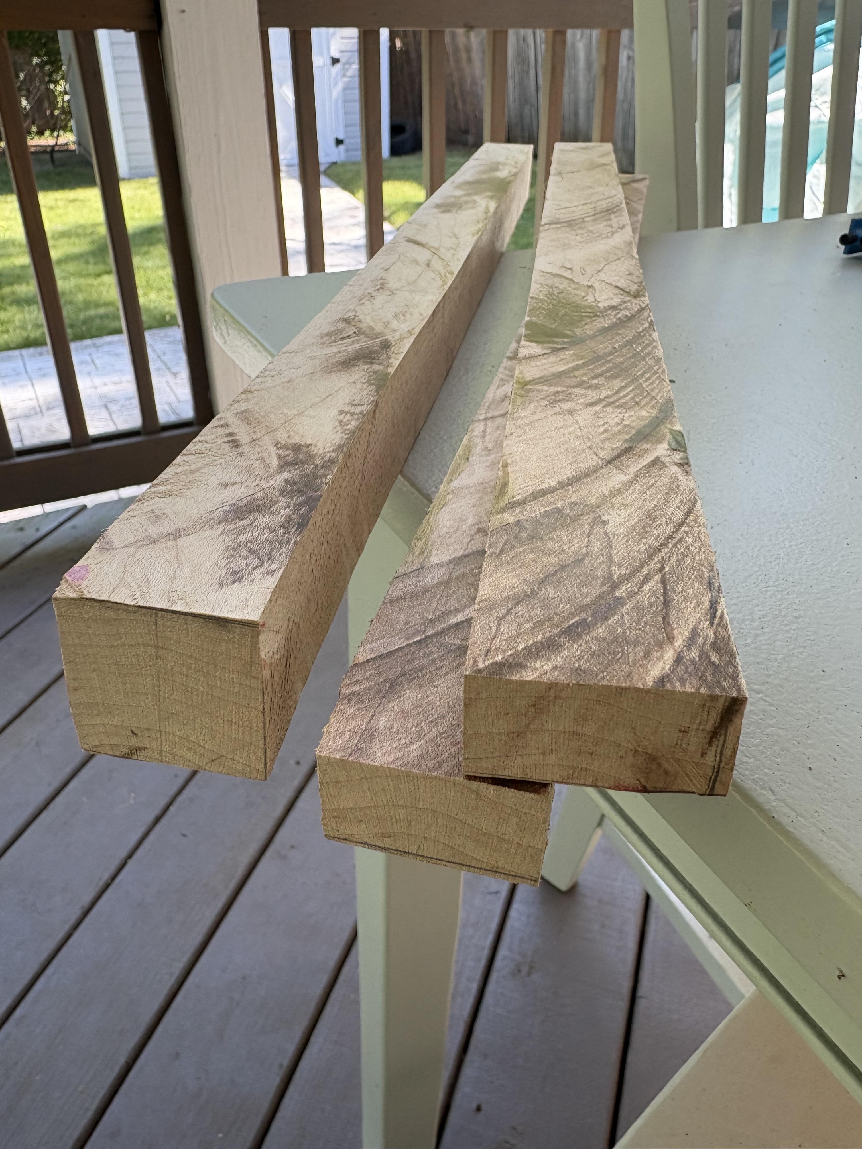

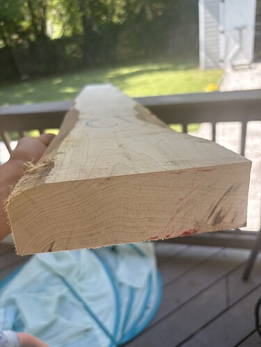

Finally got my hands on some hard maple. Will post some pics of the cuts in the next week.

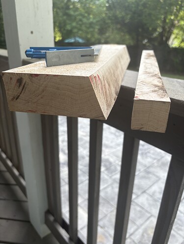

Sorry guys, got really busy with work. Finally got into this maple. Used combo of hand saws and table saw to cut into laths. Will post pics when I’m able to steam and bend.
You should bend in the opposite direction to a wooden bow, i.e., the bark is on the belly side. Thickness is important. If you’re bending without metal strips I think 14mm is the minimum.
Yes, I cut the laths 18mm thick x 35mm wide. When you say opposite of a wooden bow, you mean bark side towards me when I’m holding the string bow or bark side away from me?

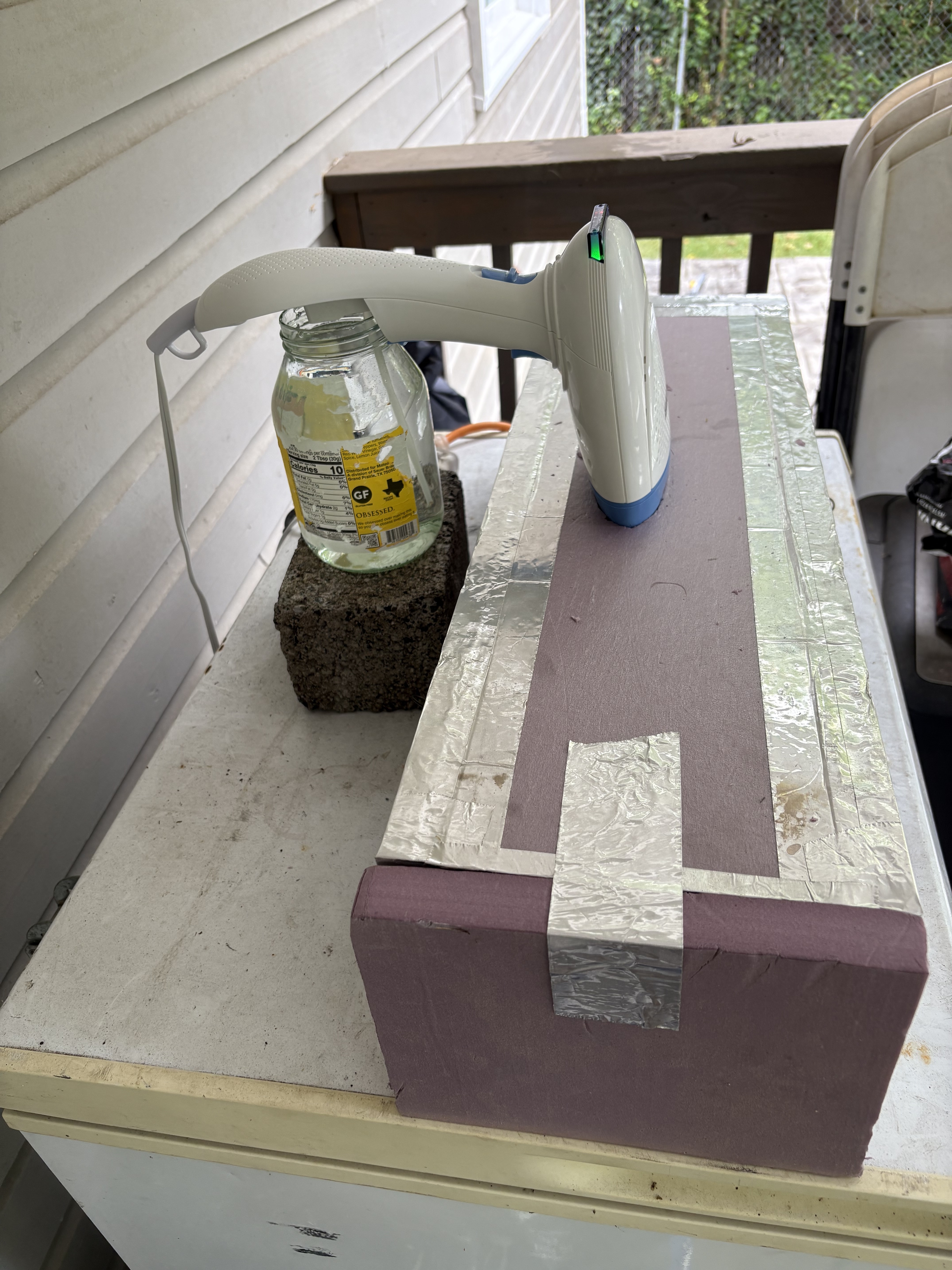

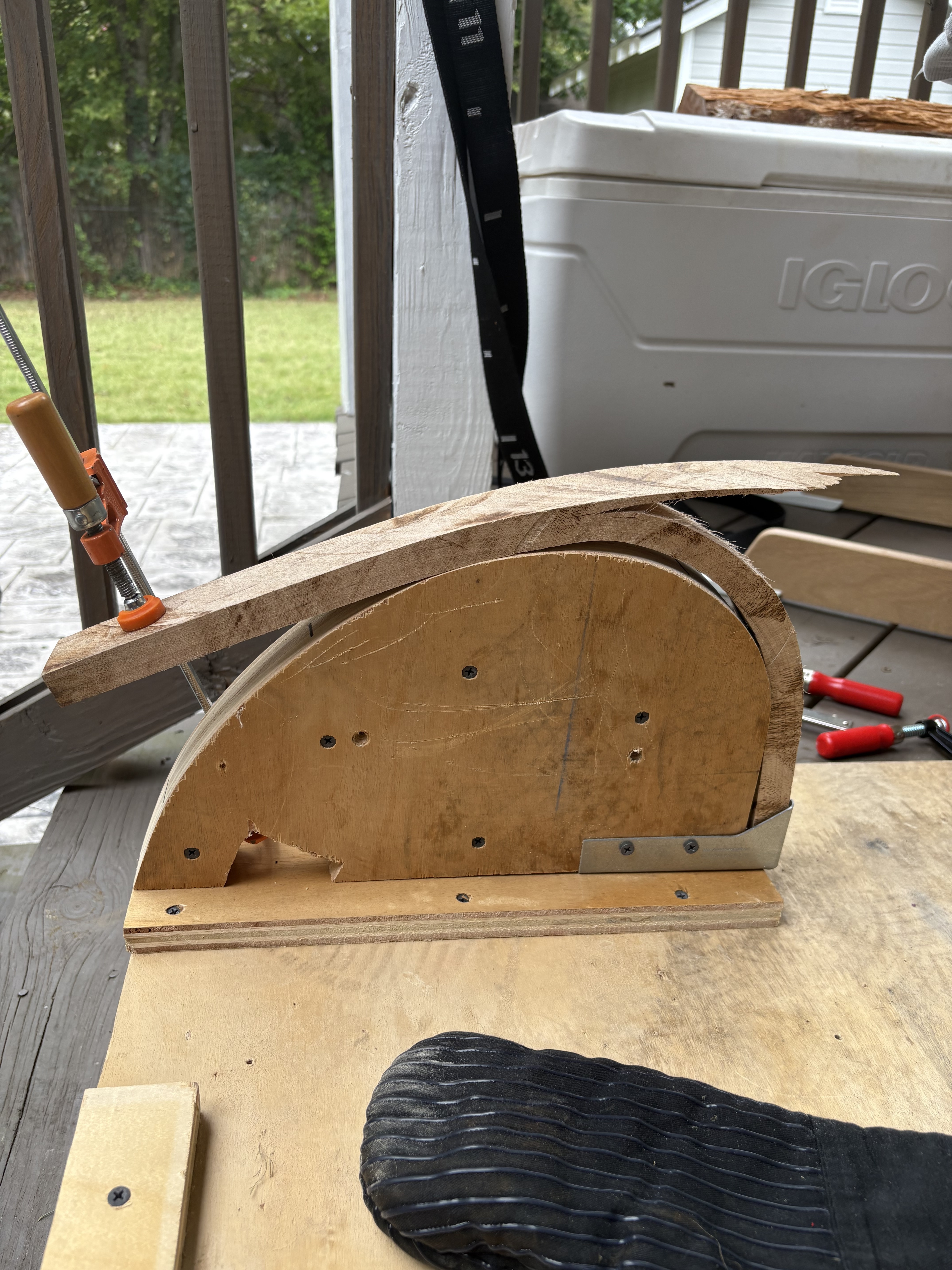

Steam box worked just fine but I’m guessing either I didn’t steam long enough, I soaked too long before steaming, or my angles are too sharp. Soaked for 9 days. Steamed for roughly 45 minutes at 150 degrees Fahrenheit.
Any advice? What am I doing wrong?
Ouch. You would need a metal strap to take the tension.
Best would be to bend thin wood and then just add extra overlays on nocks. I couldn’t bend 12mm+ maple like that either without veritas strap.
So nothing to do with how long it soaked or steamed?
And can I salvage this piece?
9 days of soak and 45min of steam sounds plenty! You could increase the steaming to 60 minutes but i don’t know how much it would help… I would thin the pieces down a little and have a new try. If you are making a short bow and under 80#, you don’t need much thickness. You can always add a nock overlay. Even Adam Karpowicz does it like this sometimes!
Another point is that the form you have there seems to be somewhat excessive. If you want to make a flight bow, just have even curved bend. Like just a circle with some extra bend at the tip.
Now your kasan bend is too much.
You could understand it like this: you want reflex, but not all reflex needs to be in the outer extremeties of the bow.
Also one thing…I don’t know about your experience, but for a beginner, less reflex is more safe.
Ok thanks, this is helpful. I’m as inexperienced as they come so the more advice the better.
How many degrees would you recommend making the bends?
I think I’ll change my forms to make more of the “boat” shape of the ottoman war bow pattern. From what I was reading in Adam’s book, seems like that may be more suited to the continuous use and extended amount of time strung in the field for hunting.
