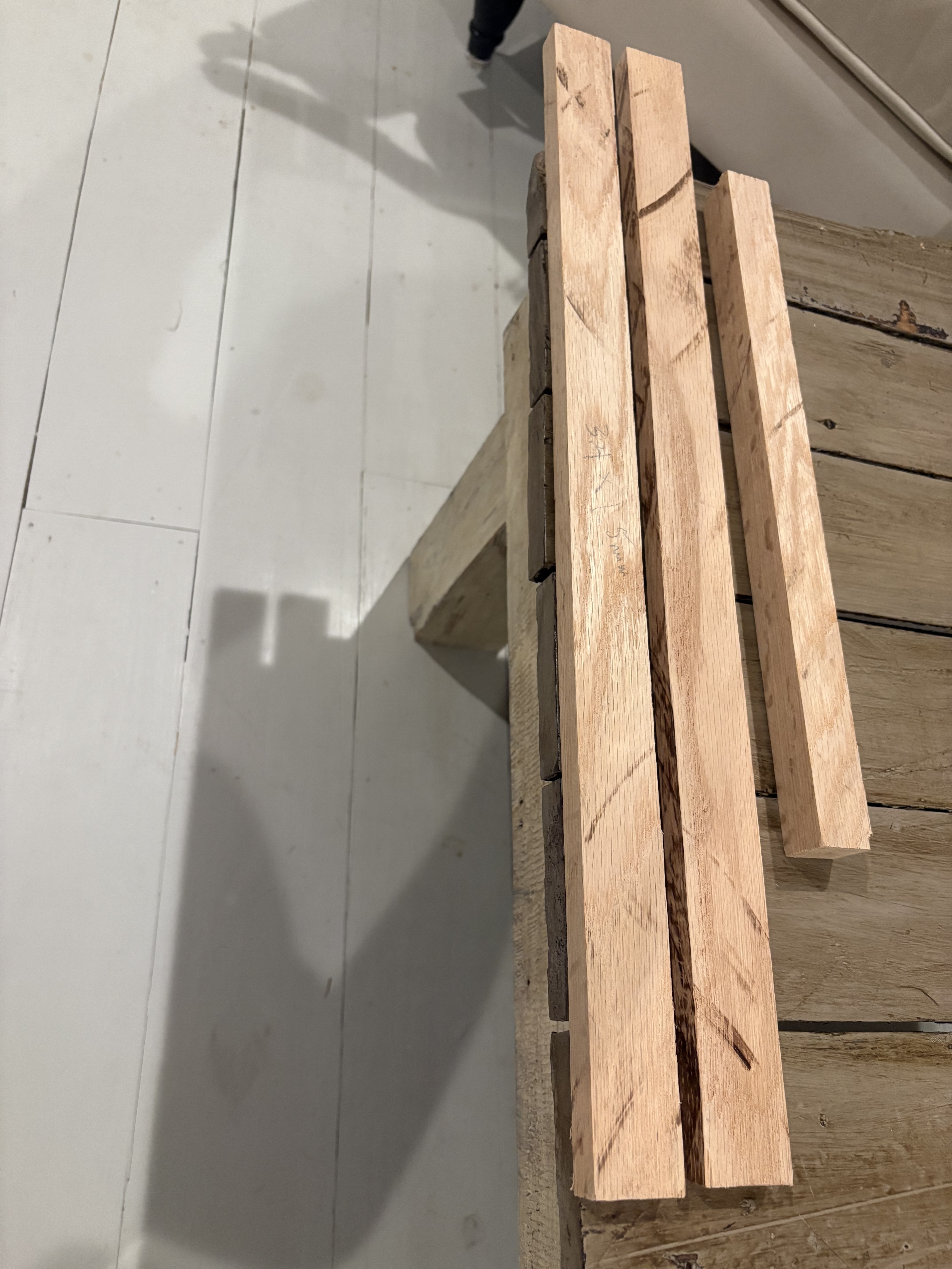

Cut my laths and grip piece today. Laths 3.4mm wide and 1.5mm thick, 22 inches long. Grip piece 1inch by 1inch and 14 inches long.
Red Oak. Found an article by Adam online saying the kind of core wood was not as critical as the horn/sinew so while it’s not traditional ottoman bow wood, I’m working with what’s available to me. We’ll see how it goes. May fail terribly. Had to cut new angles on straight grained square dowels with my table saw to get flat grain.
My reason for wanting to make an ottoman bow is that it’s compact and powerful - perfect for the close in archery hunting I do in the woods. Warriors of old made their own weapons and drew blood with them, and the challenge of that appeals to me. Gun hunting is too easy, and compound bows are too precise.
Oak is not suitable for The core, or at least I’ve never seen a bow with an oak core, I think oak might be too brittle/not very flexible. Woods that are suitable are maple, bamboo, Mulberry, elm, ash
That’s what I’ve heard. Good practice anyway till I can get my hands on one of those.
Definitely concerned about it being brittle. I test bent a 4mm x 30mm x 36in strip by itself with nothing added for strength and it bent to about 90 degrees without cracking or splintering. Curious how it will do with sinew/horn on it. I suppose the shock/vibrations from string release is really what I need to be concerned about?
I would worry more about whether such a bow will survive than whether the bow will vibrate when shooting, the wood for the core must also take glue well, I have not seen a horn bow with an oak core but I remembered that medicinebows made a Turkish bow from black locust which also does not seem to be the best choice
How did the black locust perform?

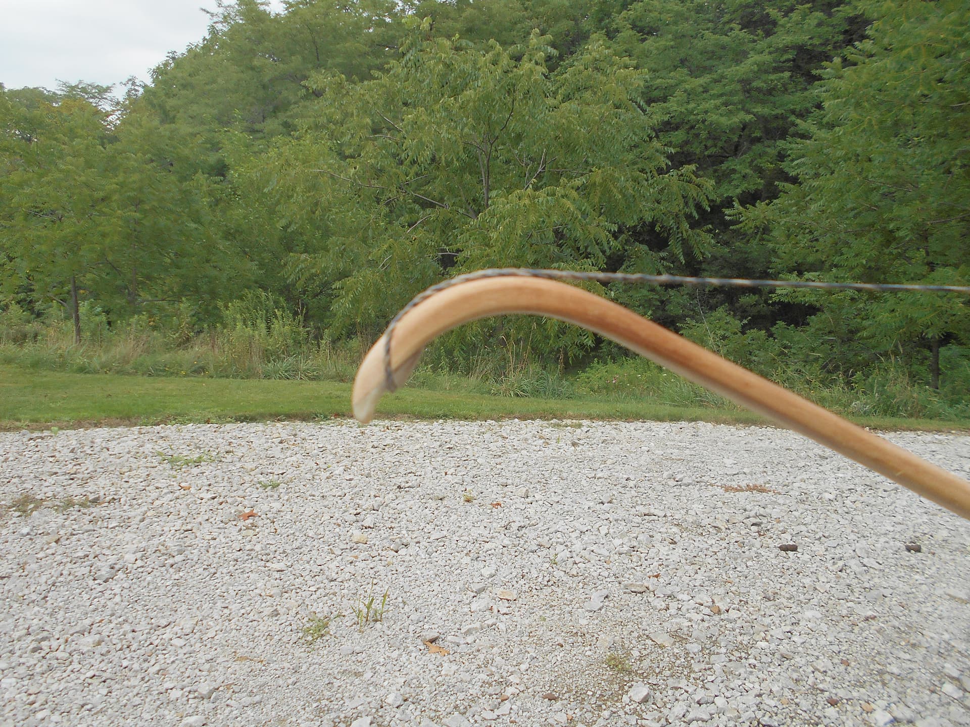

Local hickory here I usually boil the wood itself for tight bends.Even close to 90 degrees on 3" tip bends.Corners rounded well and around 9/16" evenly thick.Dry heat tempering after dry to prevent any pull out of recurve.It takes glueing well and has the proper elasticity.

I can tell you with confidence that hickory is more elastic than ash or mulberry.Elm is more elastic yet than hickory.
