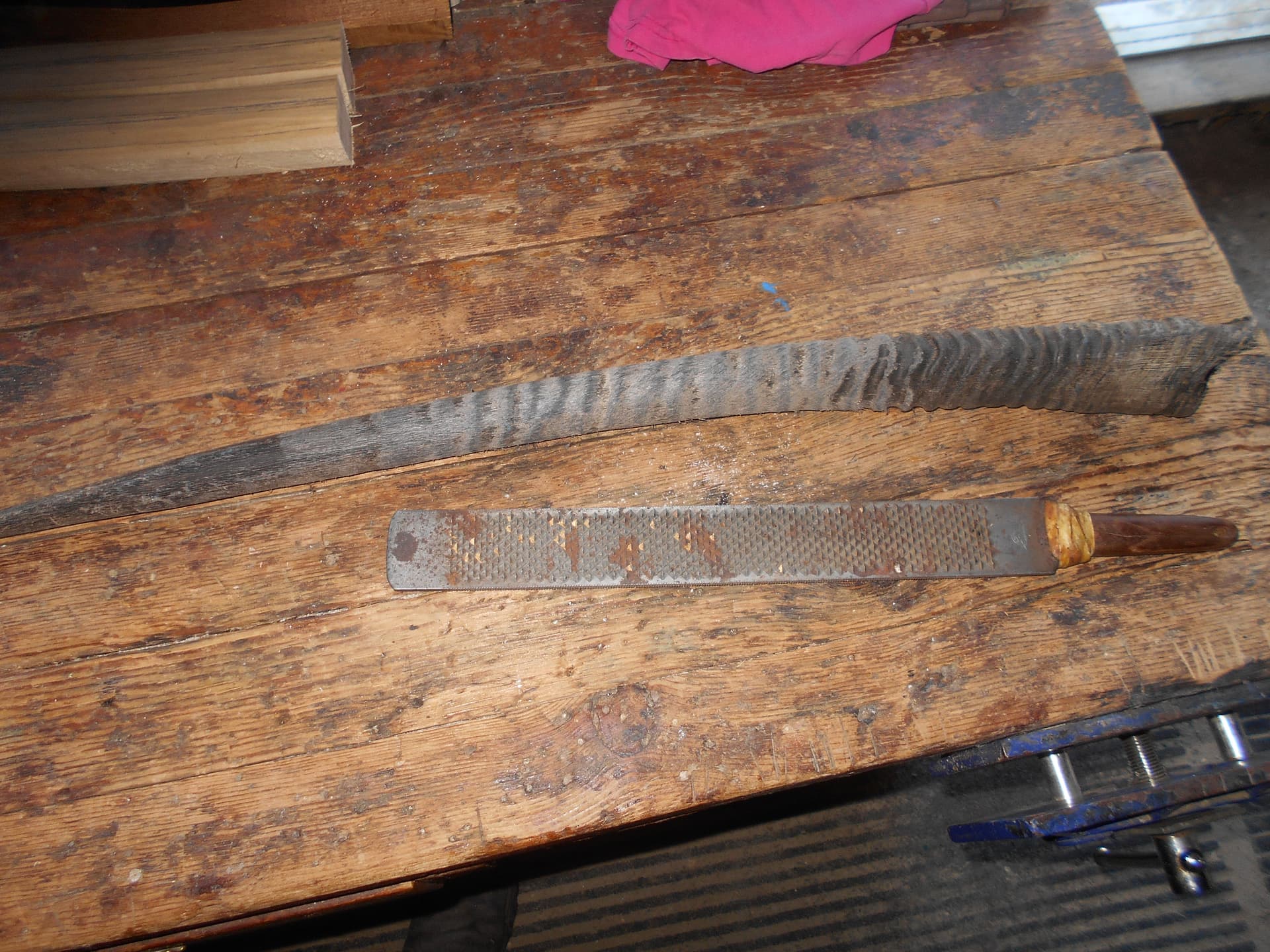

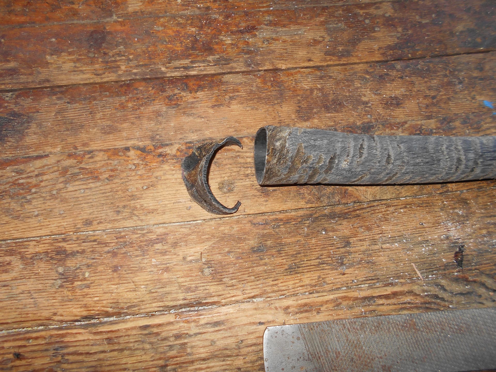

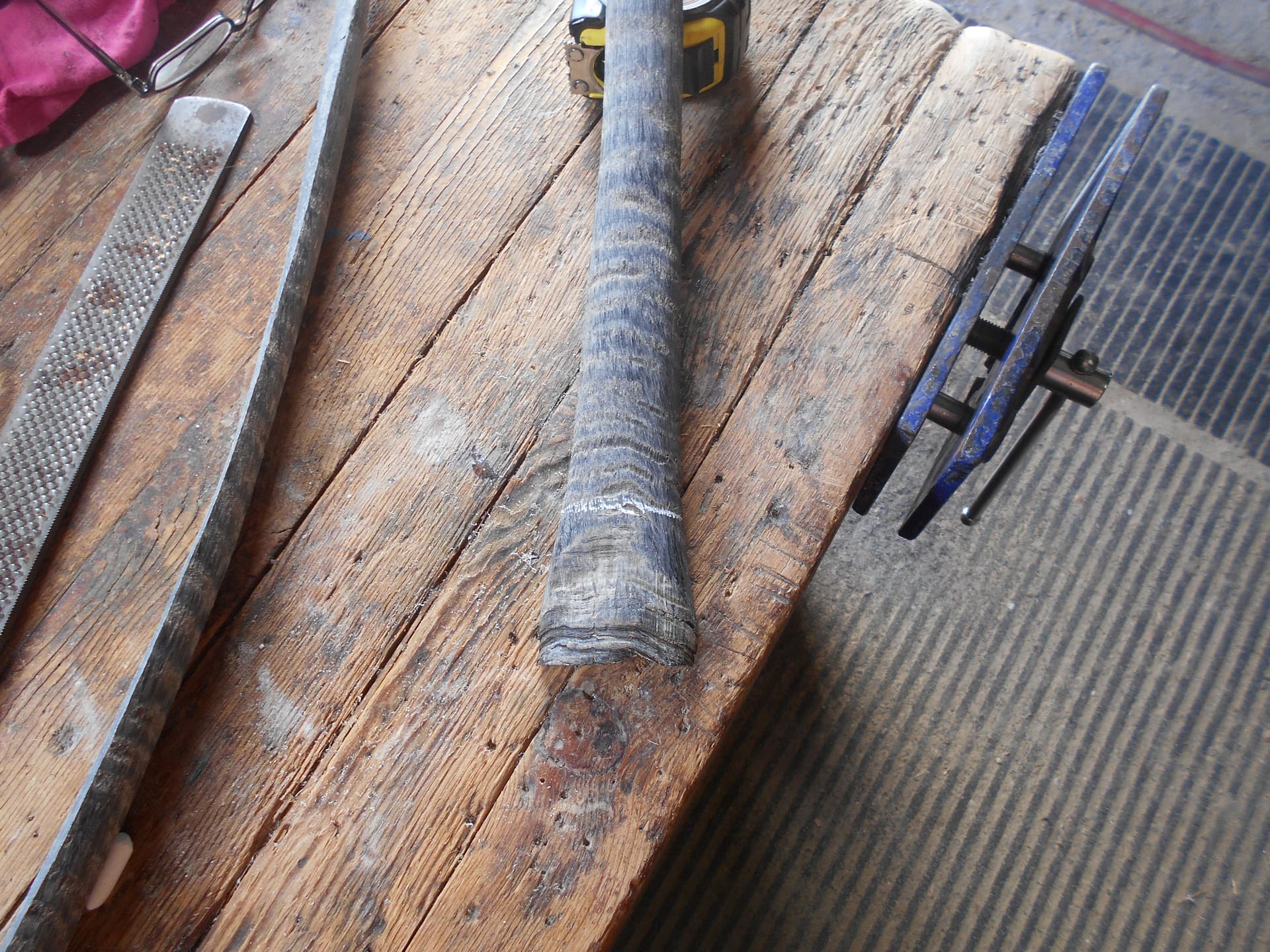

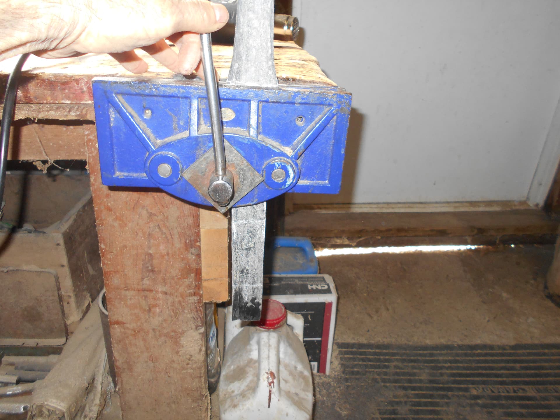

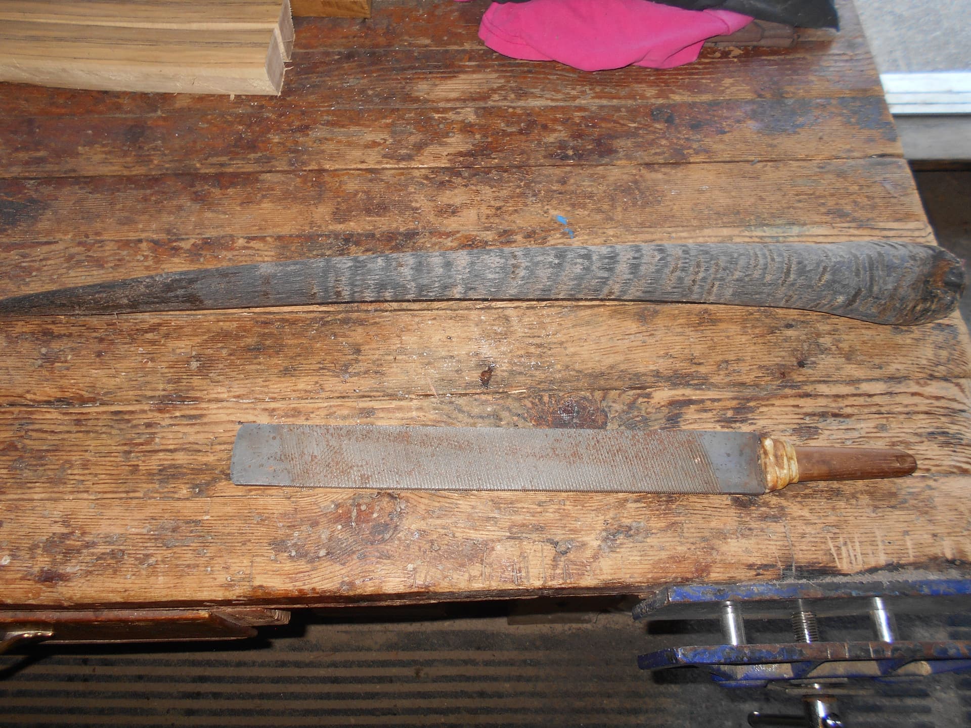

I have a process I"ve done many times to make them usable.

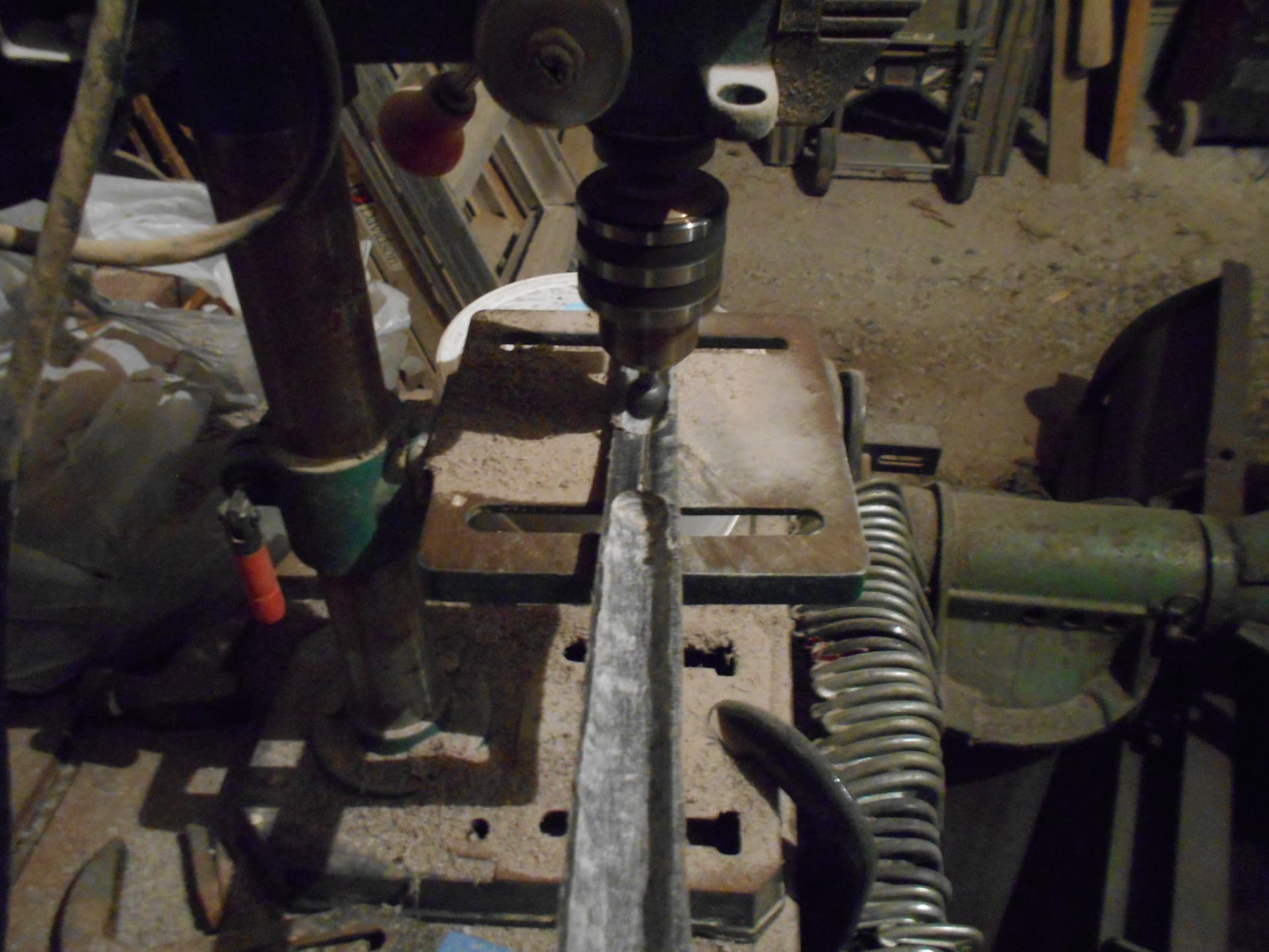

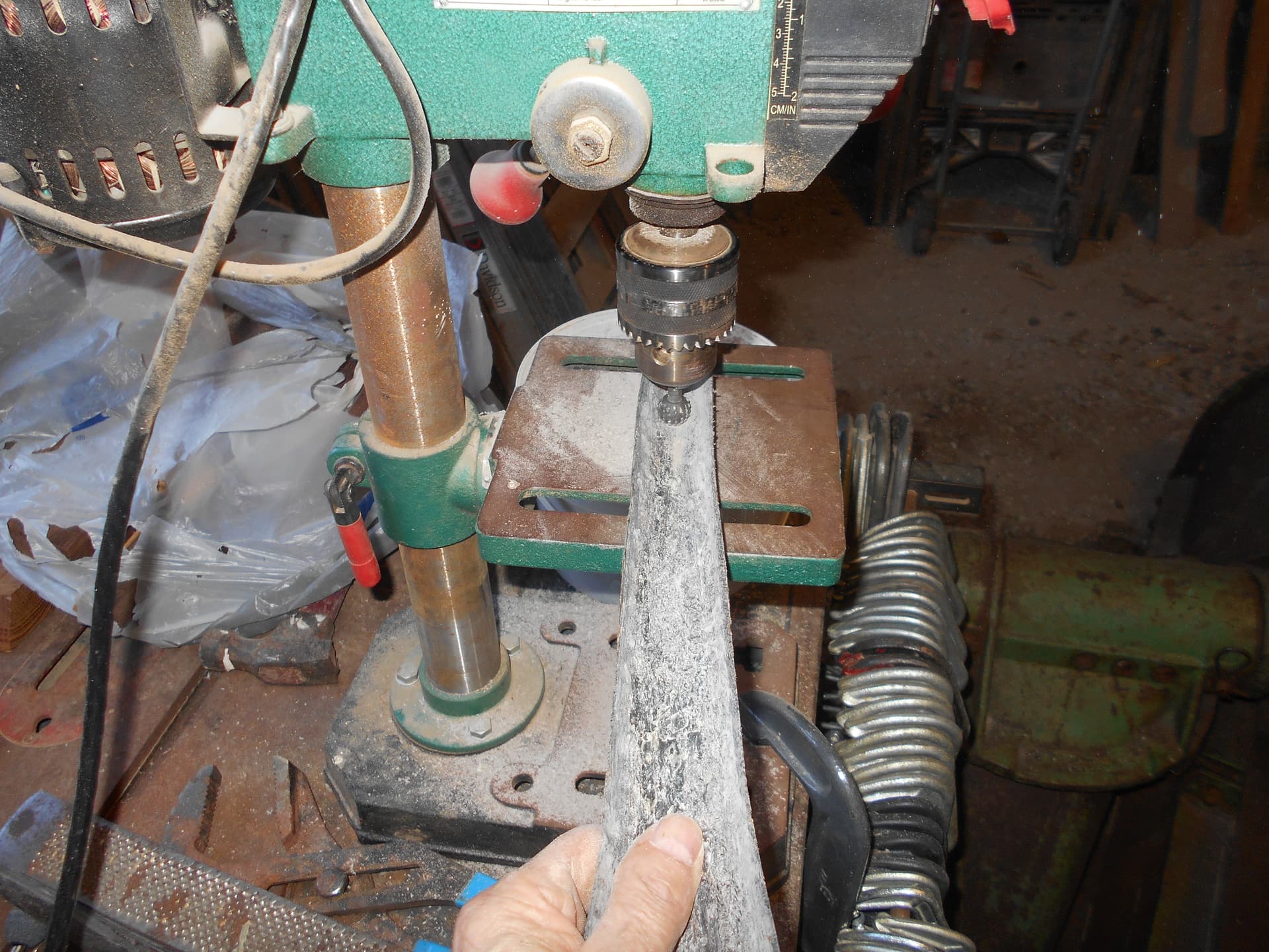

Rasping ridges off first.Then sawing length wise.Then to a drill press with I think
1/2" round file bit set at 3/16" to 1/4" depth on the press table for overall even thickness throughout.

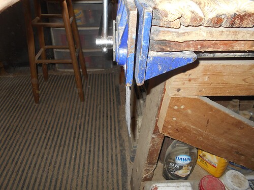

Then to my 4" by 10" cabinet vise and a heat gun to flatten the horn around 3" at a time.Trying to flatten thicker than this can create cracks.Holding heat gun around 3" away at around 350 degrees and letting the heat sink in.
One may not believe it but I do not see that amount of heat harm the integrety of the horn.Do not heat it so much that it bubbles though.That’s a no no.
Then do the final finishing of it on the sander.
Once one learns how to get success with the process it can get consistent.

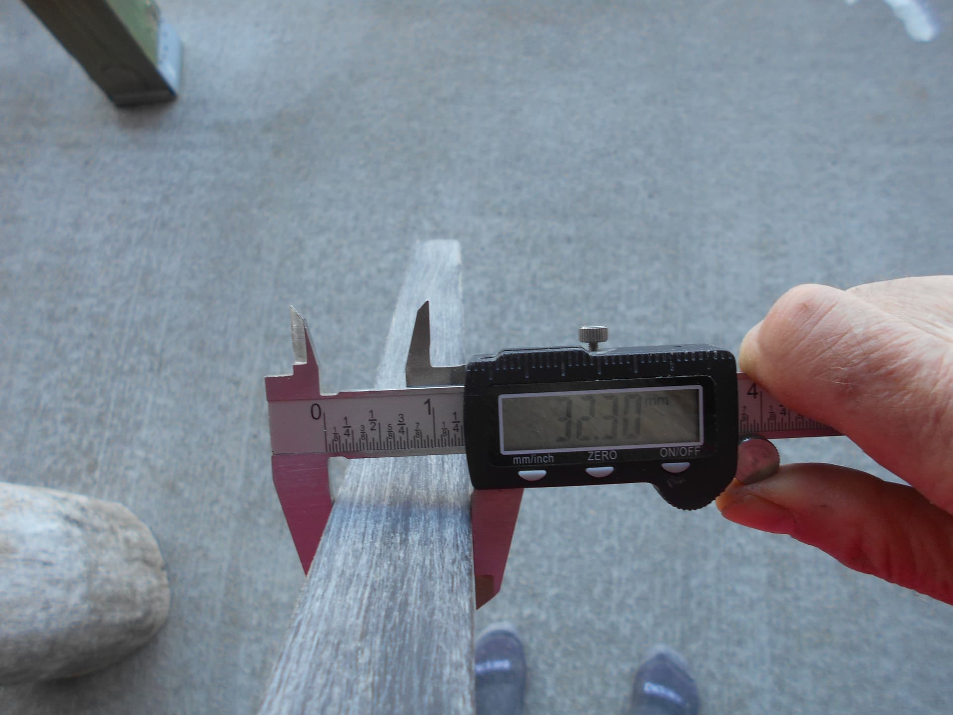

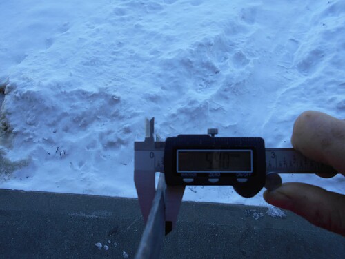

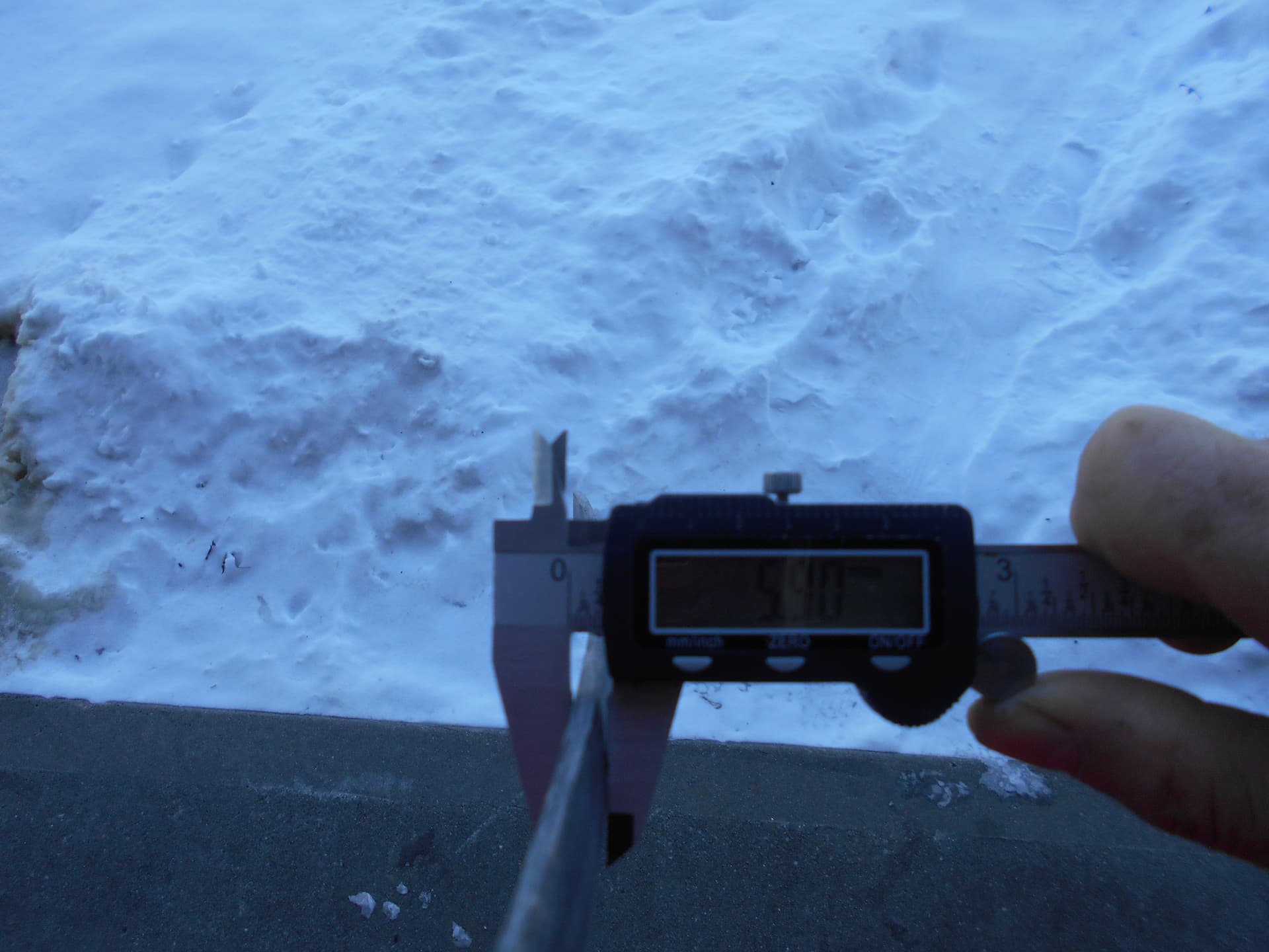

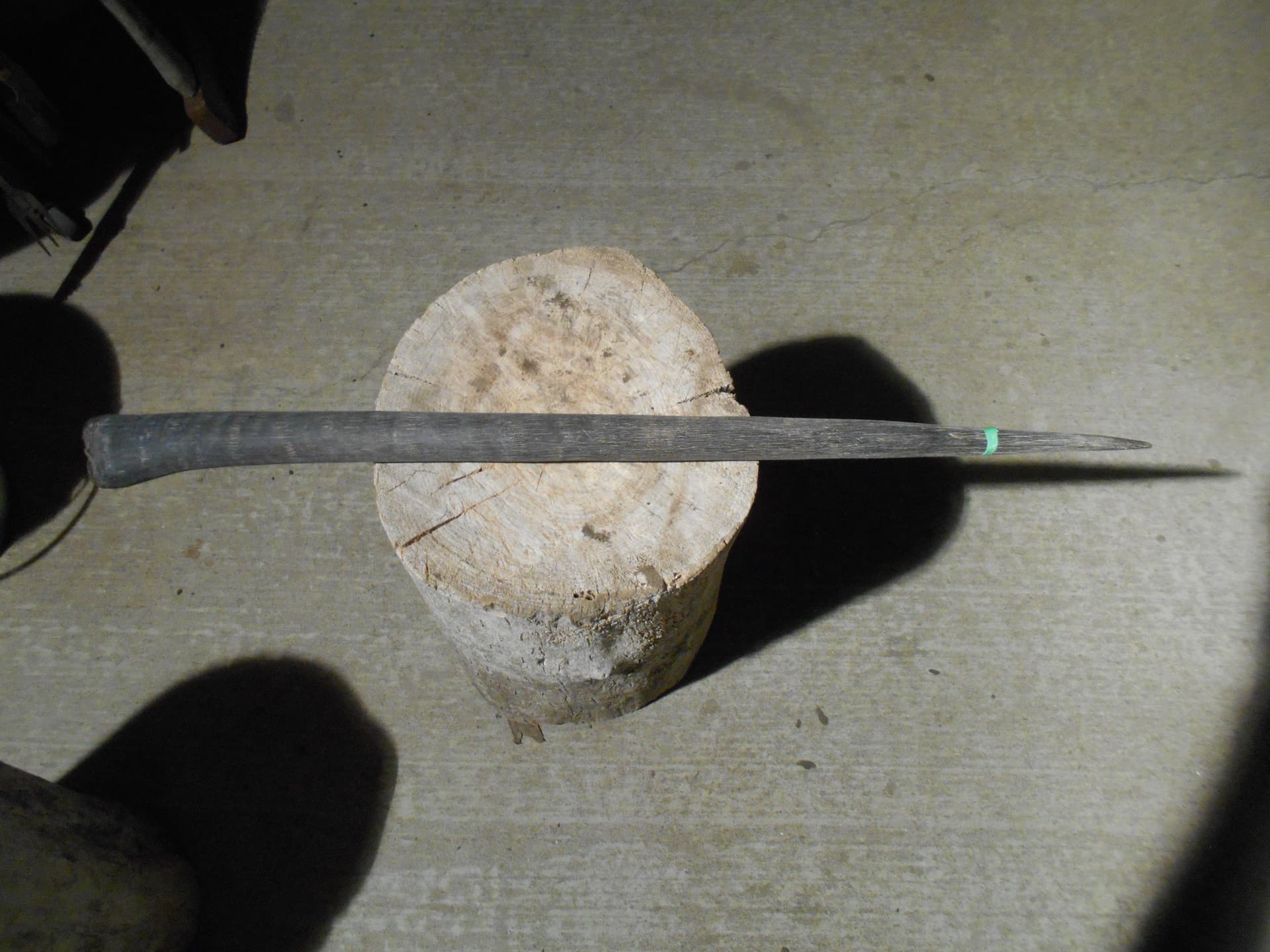

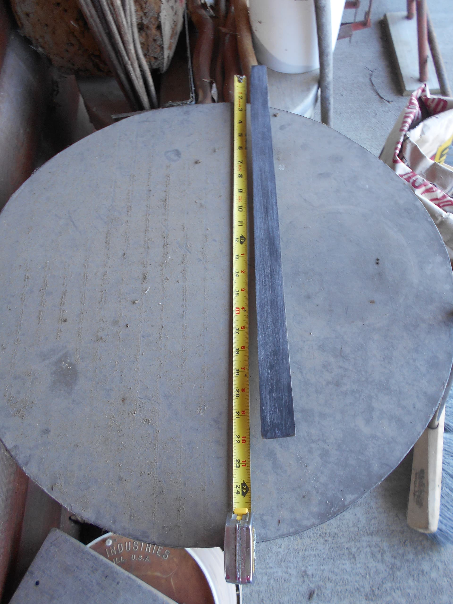

Here’s the dimensions I can come up with.I think they would be suitable for even a 90# plus horn bow.
In case my camera shot was’nt clear enough that’s 5.90 mm thick midway and 32.30 mm width at close to 22" long overall.Of course in the handle area where it’s stiff anyway the thickness is around 1/8" or 4mm thick.

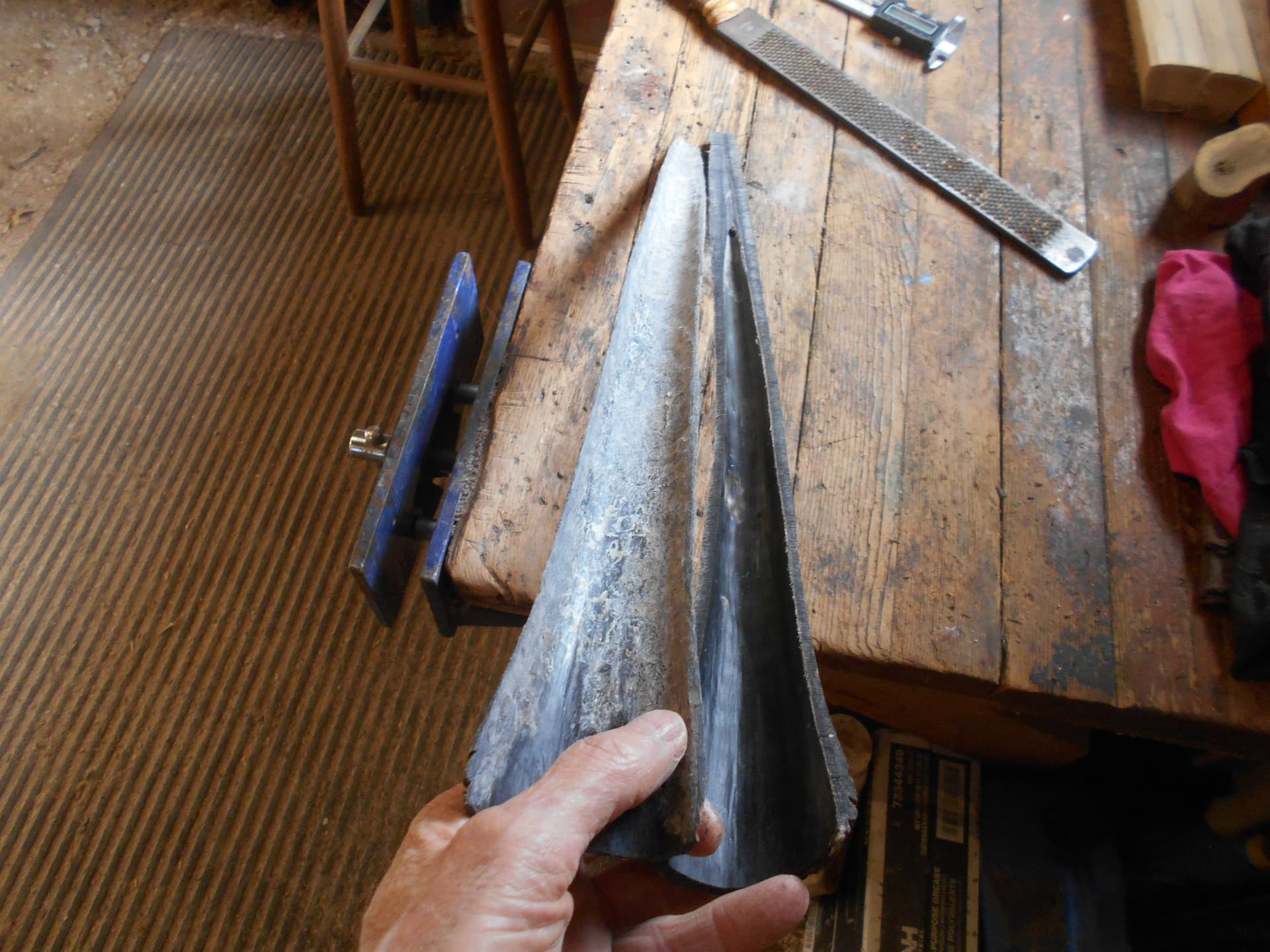

Finally got these horns on the yard.I might show how I reduce them on here if a person wants to see.They’ll be lots of pictures that’s for sure.
Go for it! Make a egyptian bow out of them? Or did you have plans to use them for these bows you have on the works right now?
A couple of cores already have the horn on them.Just need to sinew them.I’ve got one bow sinewed curing to be tillered in may.These horns are for the future bows.
It can be a crap shoot buying these horns yet even though they are cheaper than water buffalo quite a bit.You buy them from a picture.You judge whether they are male or female.
You want shorter wider horns which will be male horns.Even the short ones are 28" long though.The narrower longer horns are females.Sometimes 36" long.Practically worthless far as I’m concerned for bows.Maybe for some sort of craft item which I’m not into.

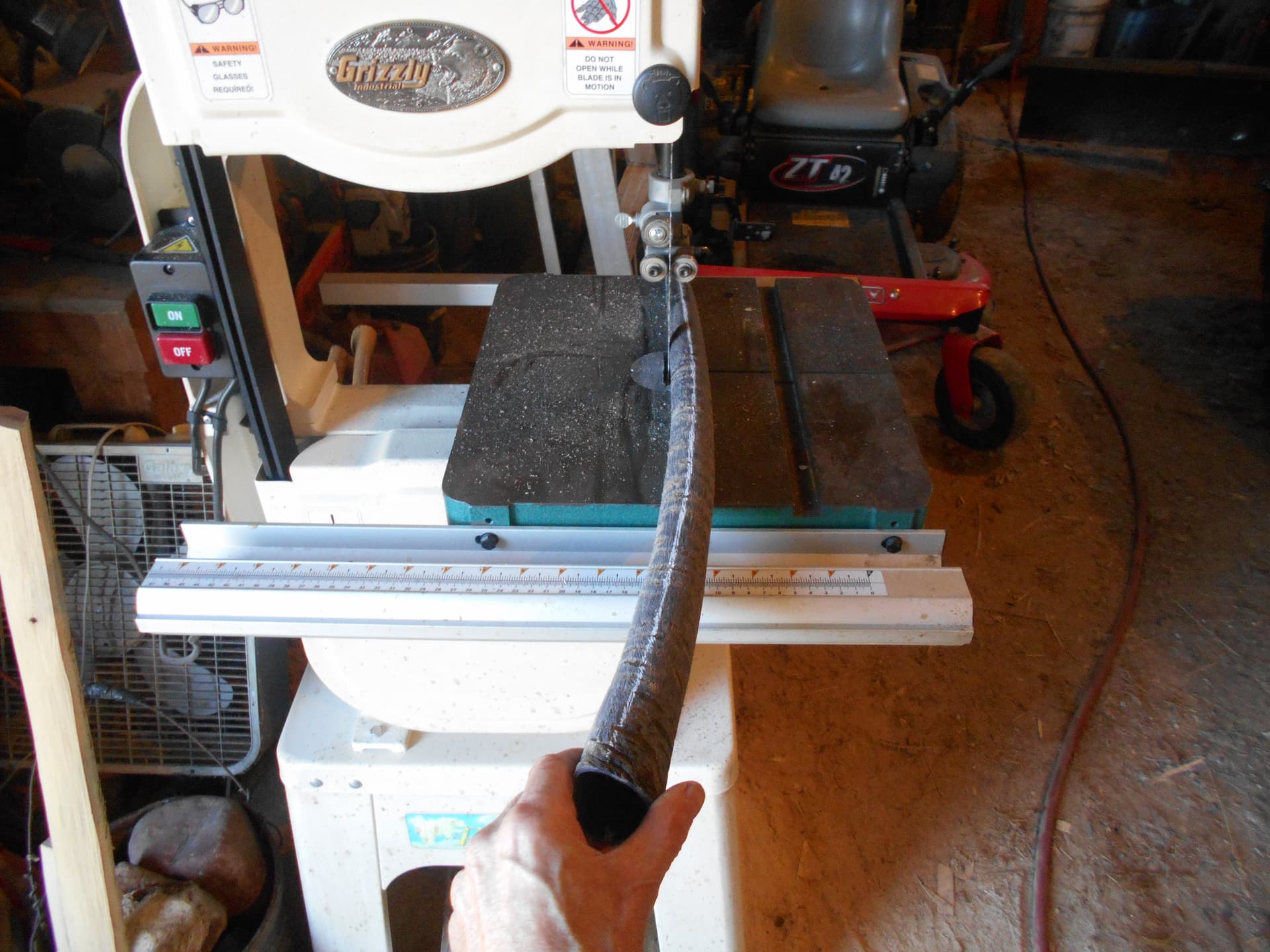

I have patience but I’ve sped the process up with power tools.

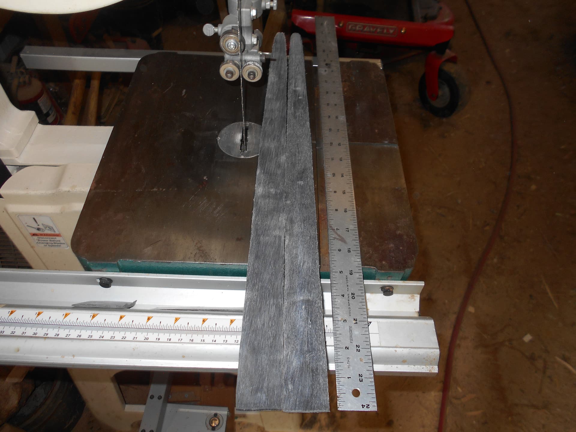

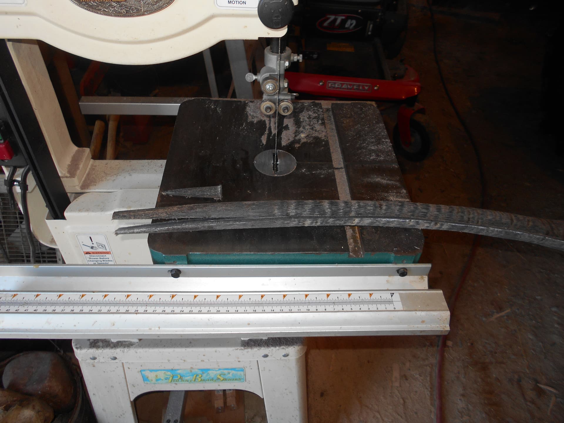

In short description ripping the horn into halves on the bandsaw first.Then I use a drill press with a round file bit set at a depth to reduce the horn.Then onto the cabinet vice [4" by 10" steel plates] with the heat gun.

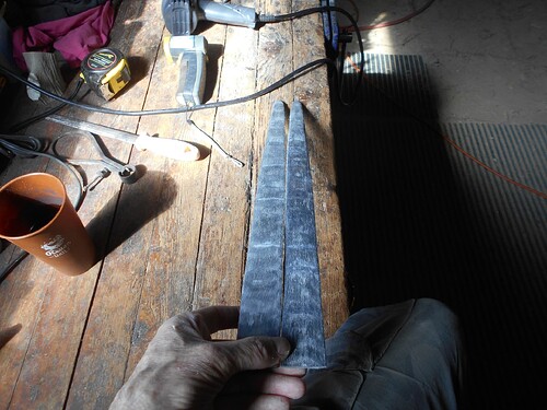

Well I made the mistake that I warned about.I’ll try to explain my mistakes.After removing ridges with a farriers rasp when ripping these horns length wise in half it should be done into a deflex/reflex profile to avoid a sideways bend.The tip is cut off leaving maybe 3/4" width.The butt end is squared off also.
First mistake…I did’nt remove the ridges as smoothly on the outside as I should have.Next pair will be done on the spindle sander and finalized on the belt sander.

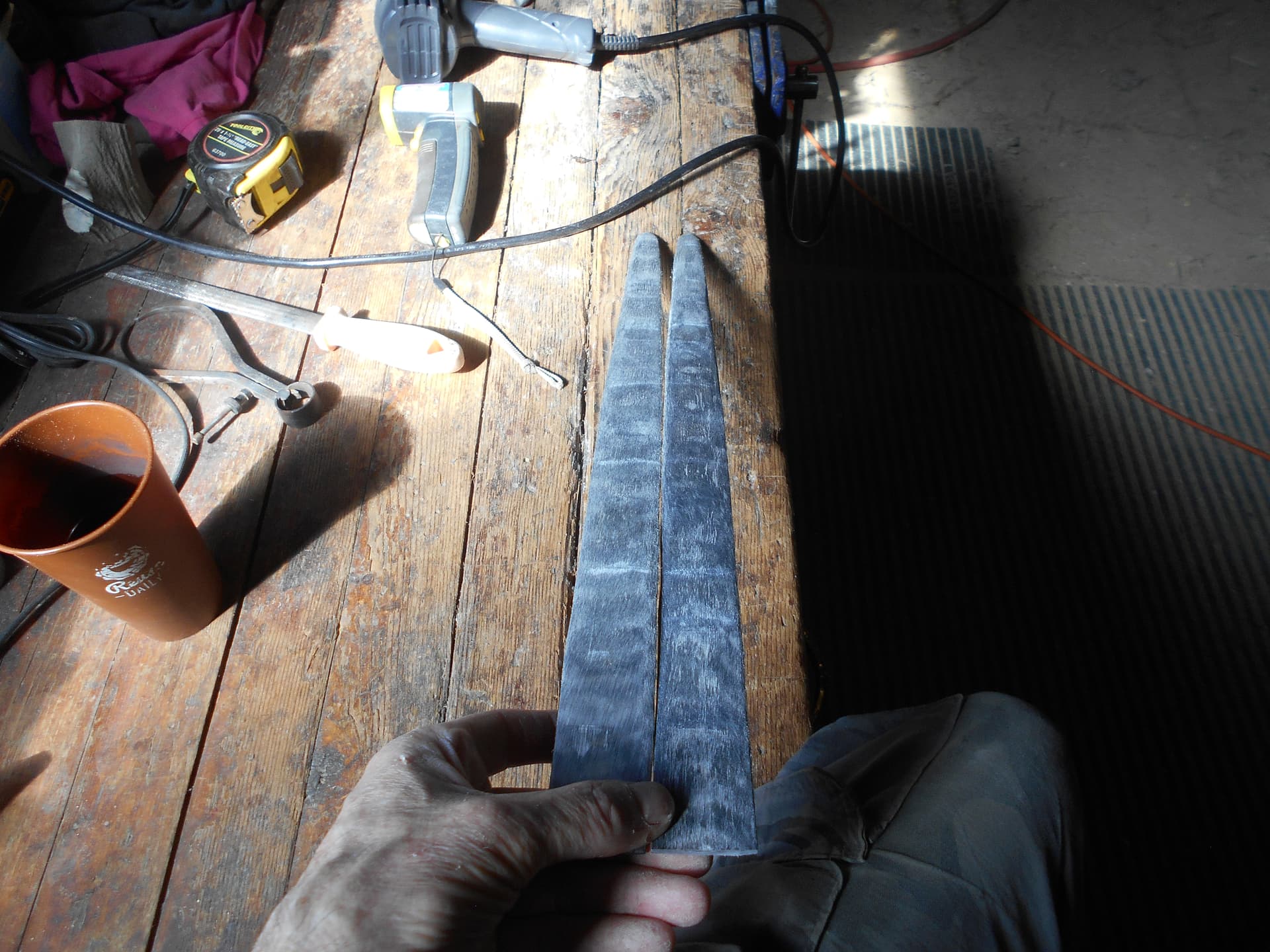

Two 24" long pieces.
Second mistake…I had my deflex/reflex pieces,but I did not straighten a bit or reduce the reflexed one before reducing the thickness at the drill press with the round file bit.It actually raised the horn slightly while running it through producing too thin of a laminate.I want at least 4mm of horn full length.I set my round file bit depth at 4.8mm.
The deflex one is no problem.

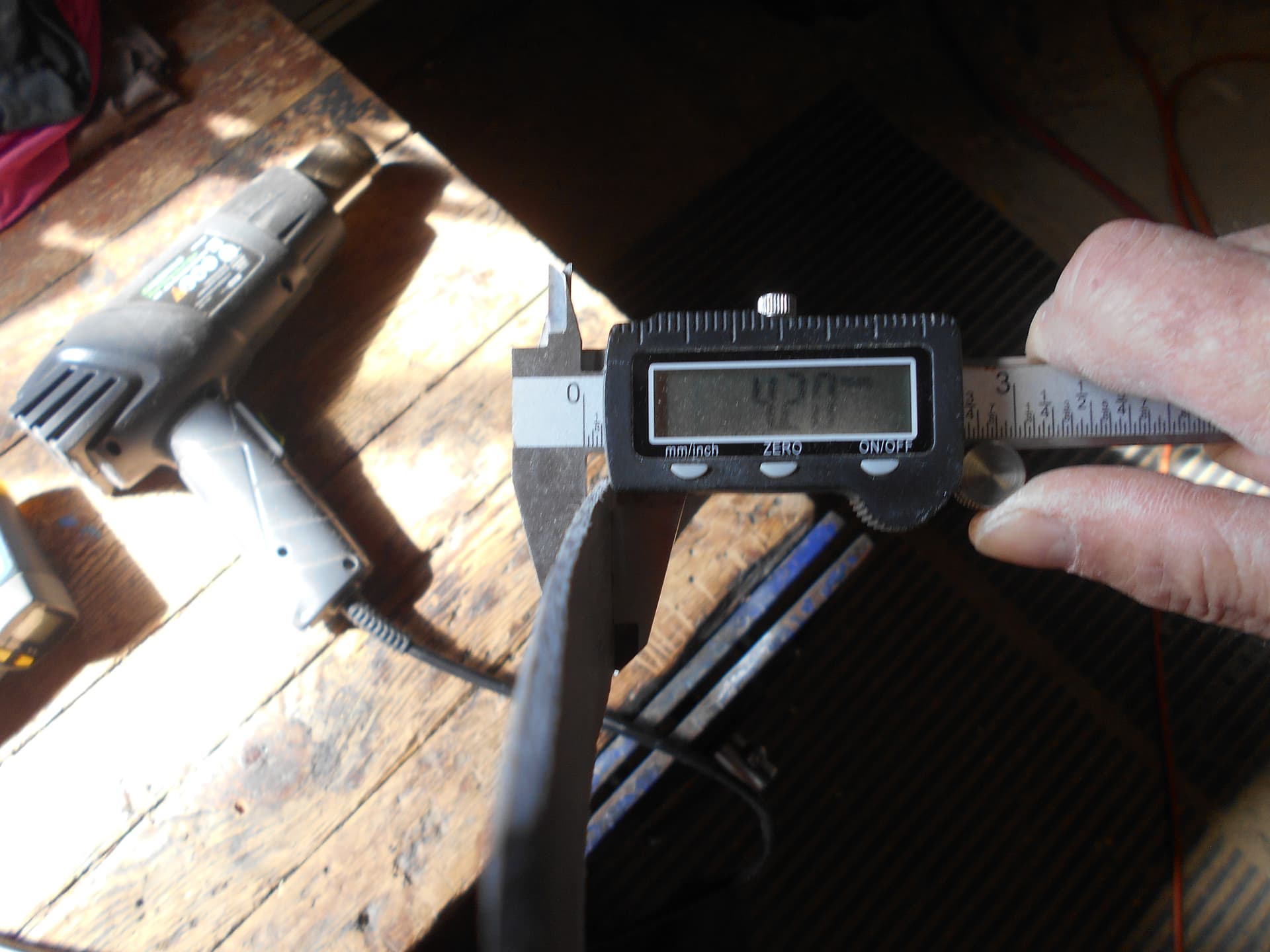

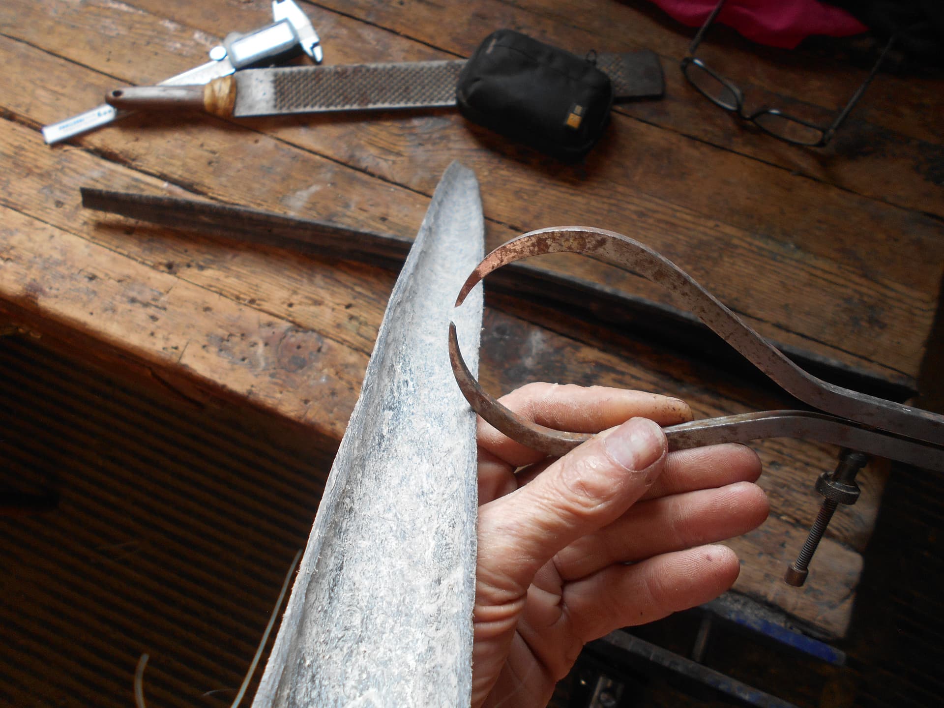

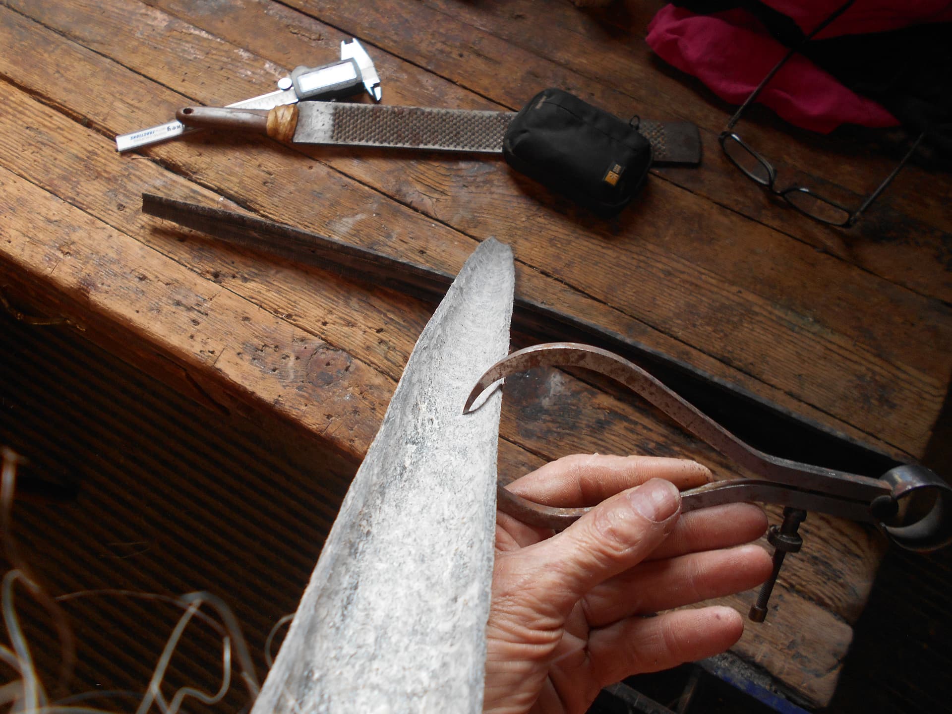

Checking thickness.I’m getting a better tool for this.An outside measuring calipers.

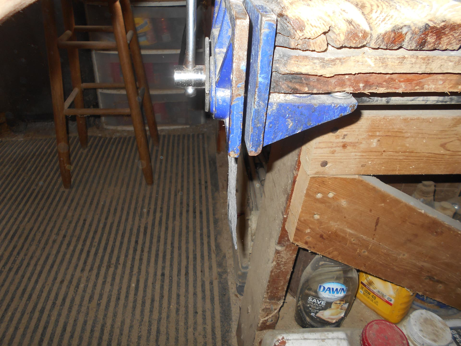

Onto the flattening with heat in the vice.The thinner lamination flattened very well and good.The second thicker lamination I over heated it making it too brittle.When flexing it and you hear cracking it’s too brittle.
It’s a fine line to avoid.Not heating it hot enough leads to cracking.Too much leads to burning and ruining it also.I believe the plastizing temp of horn is about the same as wood.Wood at 350F.Horn at 350 F.It’s a fine line as thicker horn requires more time for the heat to penetrate fully and thinner horn requires less time.
A person gets the hang of it with practice.
I’ve seen those who soak the horn in milk prior or steam to flatten it.I’ve had great success doing it this way with the heat gun.One needs to be careful though.Thing is I never get to see their results using milk…ha ha.
I’ve seen sheep horn stew boiled and straightened.A lot thicker horn also.It needs to be left to dry and set for weeks.
Third mistake…I got into a hurry and held the heat gun too close to the horn occasionally too much.I usually check the temp with a laser thermometer.I did’nt.It’s important to hold the heat gun at least 2 to 3 inches from the horn checking as you go letting the horn slowly heat up.I did’nt.Browning occured and made it brittle in an area rendering it useless.Very disappointed of course,but I will try again.One does not get anywhere quitting.
So…a warning do not over heat the horn…ha ha.

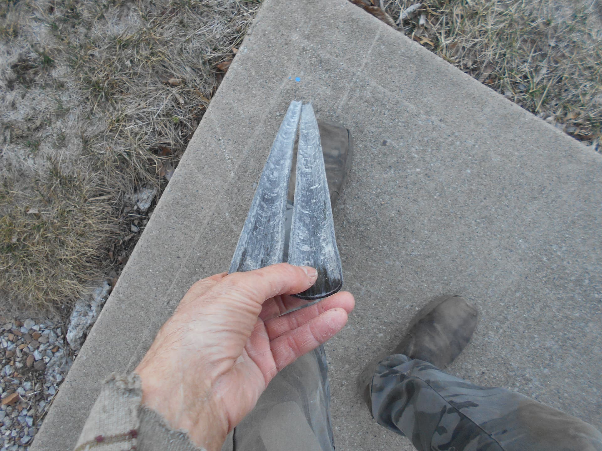

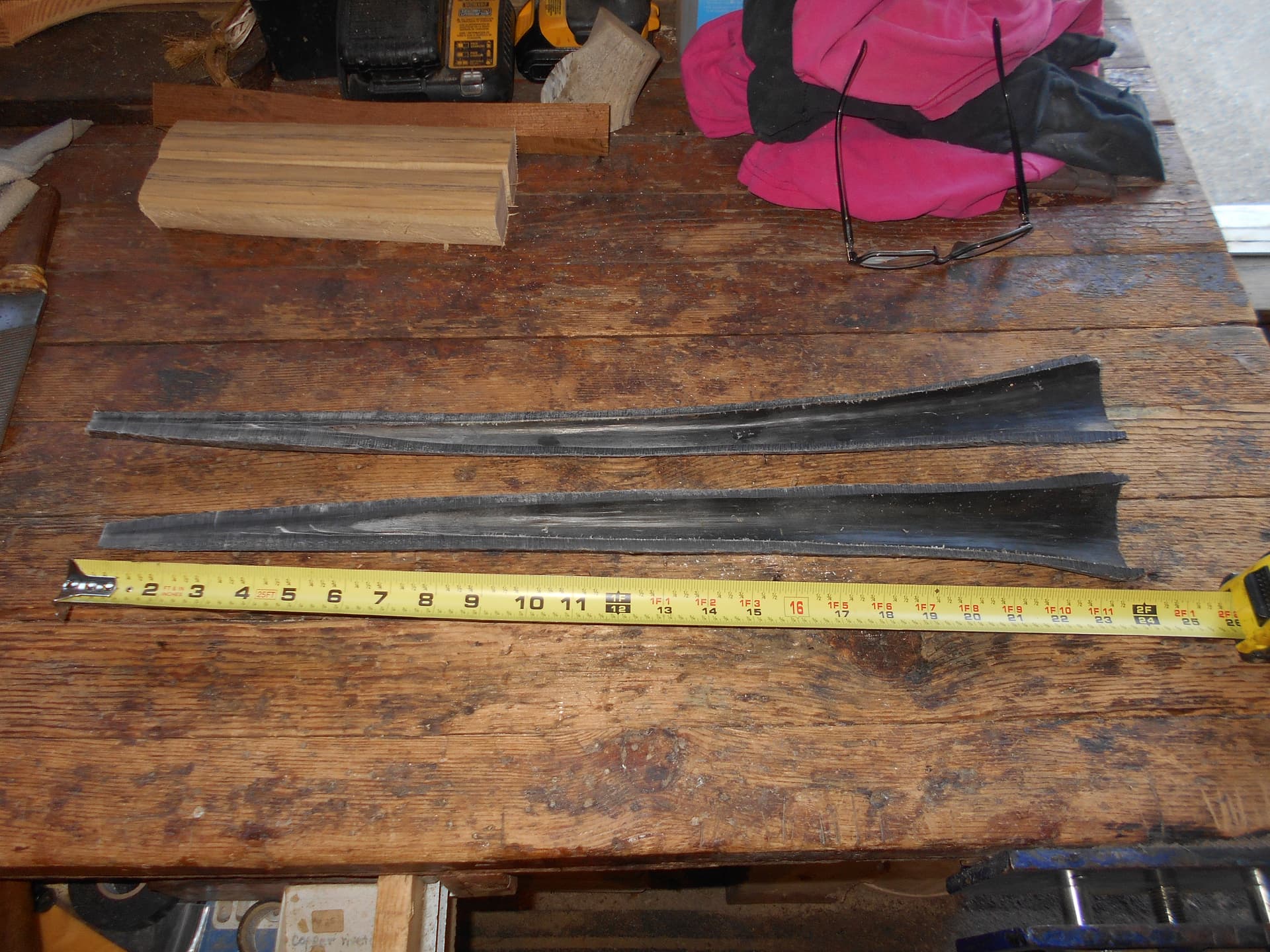

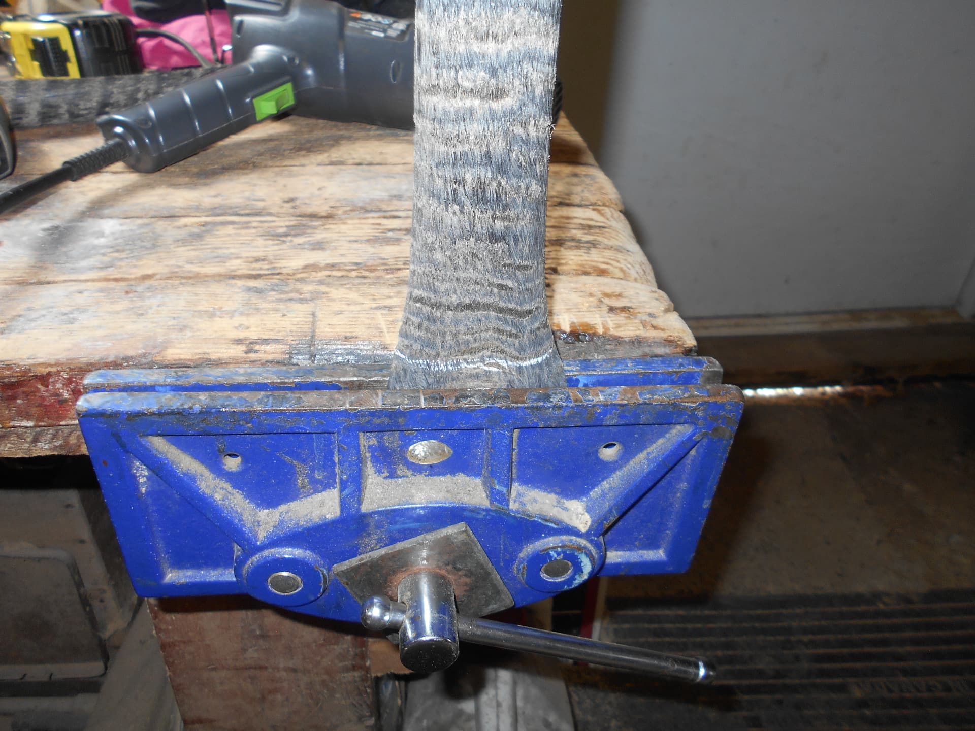

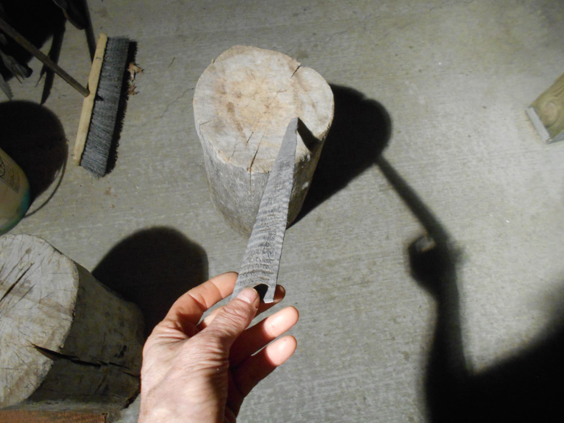

Ta da…success.Two laminations 21" long.1 and 3/8" wide out of the fades.4.20 mm thick out of the fades…Plenty for a 50# bow.4.20 mm may not seem like much but it is enough for close to 25 pounds of draw weight.I flexed them a bunch and they’re alright.No scorching this time.
The method with the heat gun is to keep the heat gun a good 3" away and keep it moving over a 2" long area for 3 to 4 minutes usually.Then quickly insert it into the vice and crank er tight.Temperature while clamping was around 350 F.
Takes about an hour per lamination.

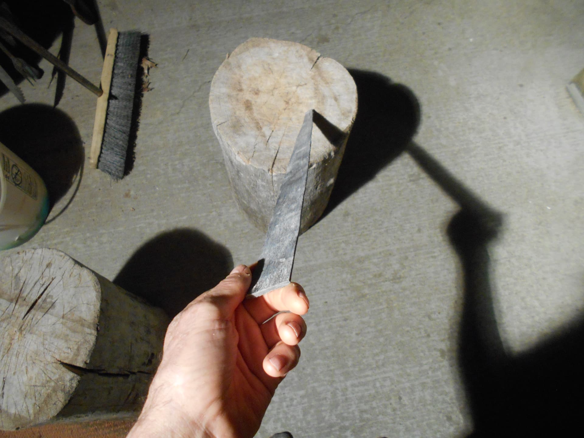

The horn needs to come off the round file bit/drill press horn removal a bit thicker than what the final thickness needed.Close to 1 mm in my estimation.
This is to afford the loss of getting all of the divets off the inner side of it sanding/smoothing and finalizing it for a smooth surface on the inner side to glue to.
The horn actually will get indication of wrinkles compressing on the outer surface while flattening.These are not much though.
These need to be smoothed off also and will be the outer surface of the lamination.
With this pair at +4.8mm off the drill press it lost .6mm from the sanding process to get to final 4.2mm thickness.

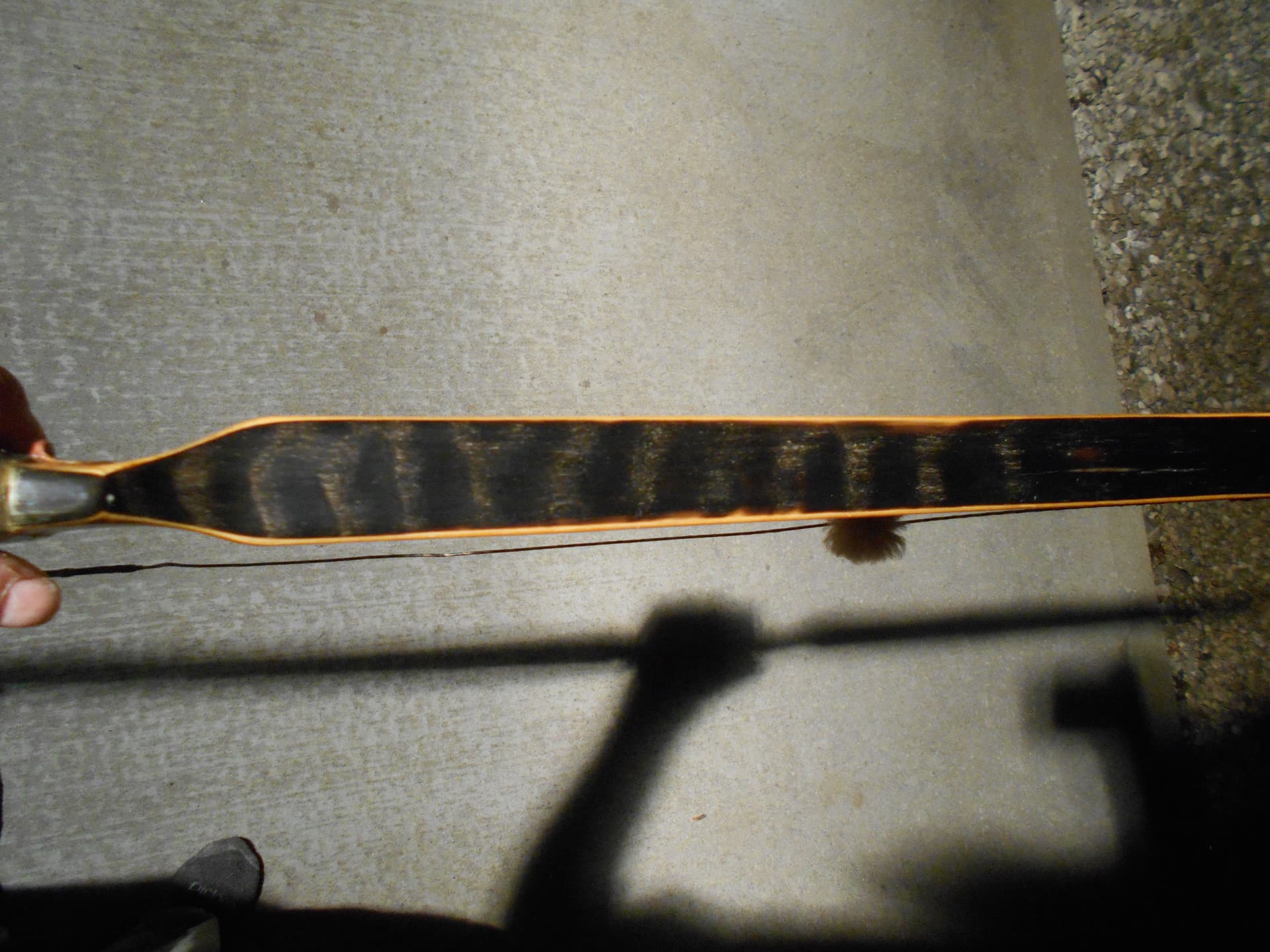

I’ve seen indications of the ridges but still smooth on some of my bows.Rather cool really !!! Every horn can be a little different also.
