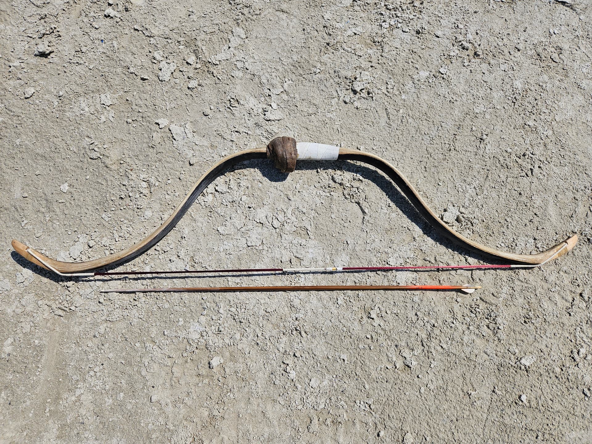

I got a double win. 635m in unlimited weight glassbow + wood arrow. 539m in unlimited weight hornbow + wood arrow. Also, both results were new competition records. So this was a major breakthrough personally for me. I did share some videos and pictures in Facebook but i forgot to post here.

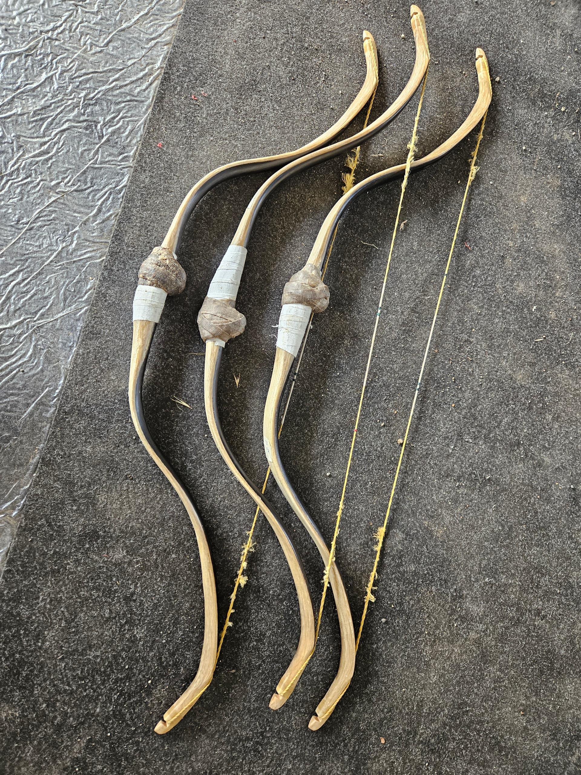

For both classes i took with me 3 bows, because i wanted to try different setups. For glassbows i had 123#, 128# and 131# bows. For hornbows i had 105#, 125# and 130# bows. You are allowed to shoot multiple bows, but arrow amount is fixed.
Surprisingly, the best results were made with the lightest bows; 123# glassbow and 105# hornbow. I think with those bows the arrows had the best match. Because the issue wasn’t with my strength or ease of draw/good release. It felt really funny when even the heaviest, 131# glassbow, was feeling light for me! I did a good strength tapering/peaking program for the competition day which payed off.
There is so much fine tuning and technique details that its hard to know why something works.
I definitely studied the bows and arrows afterwards so now i have good idea how to progress towards conquest cup 2026 and utah flight shoot 2026.
I wasn’t happy with the hornbow result (539m). It was pretty bad for the bow poundage and general quality of my work otherwise. In that sense my double win came easy. I’m looking to do much better next year. And i should.

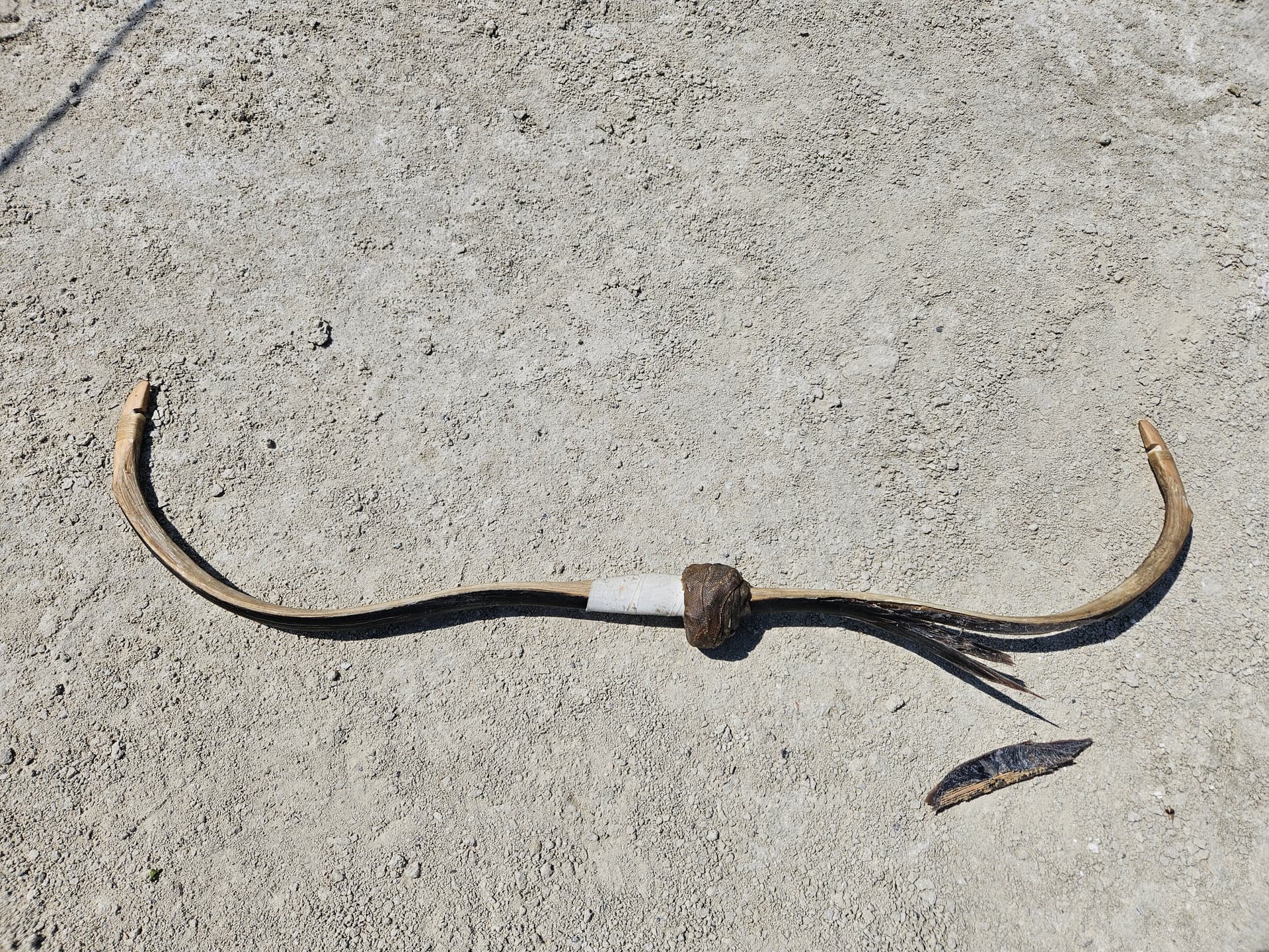

Having a finish in the bow is one important thing. This year i just tried to “survive” with heavy enough bows and get good shots. I didn’t really have enough time or effor to put into finishing them. Although now looking back i should have atleast lacquered them. Now i didn’t have anything on them. For next year i want to experiment with artificially drying them. This combined with either just lacquer and/or birch bark should give out significant performance boost. The bows would be much more snappy when they are not allowed to soak in moisture.
Actually, i think this might have been the issue why my heavier hornbows didn’t do better than the 105# bow.

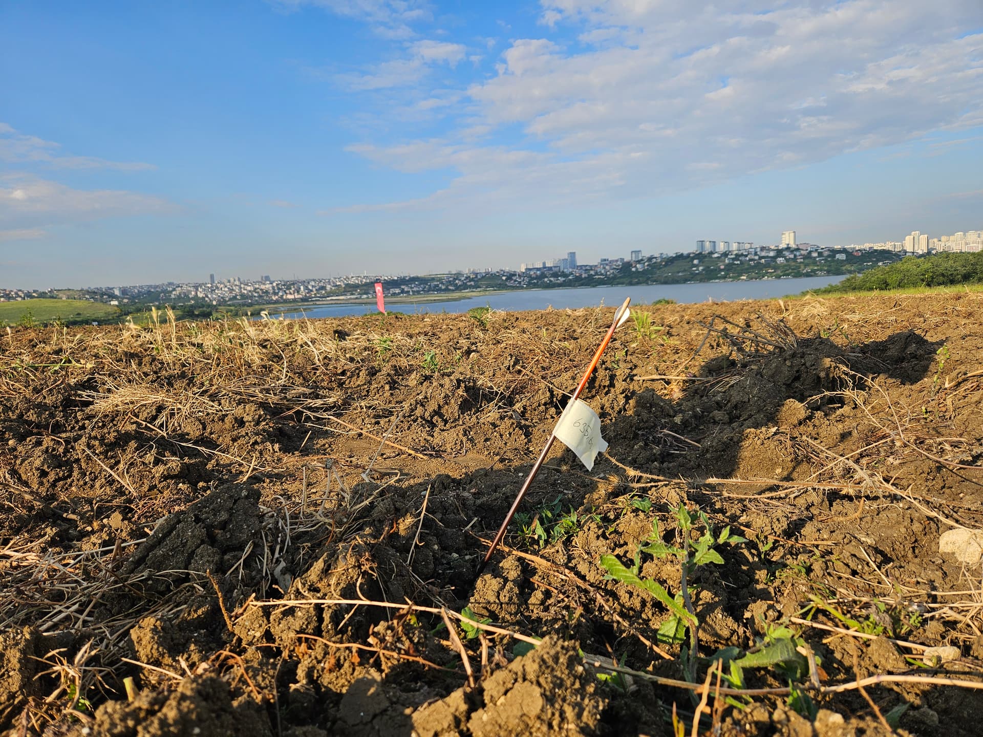

We shot 11 arrows. So you actually need some luck with this amount, especially when the weather fluctuates. This is why the turks shot many many competitions trying to achieve those records. They even had these private shoots where they brought a judge with them and tried to break a range record. To our culture that is not a competition. That’s much easier than competition.

Heat treatment like timar greatly effects the efficiency of the bow. It might not show much with heavier arrows, but light arrows really benefit from heightened limb efficiency. I wouldn’t be surprised if it increased the results by 10%.
