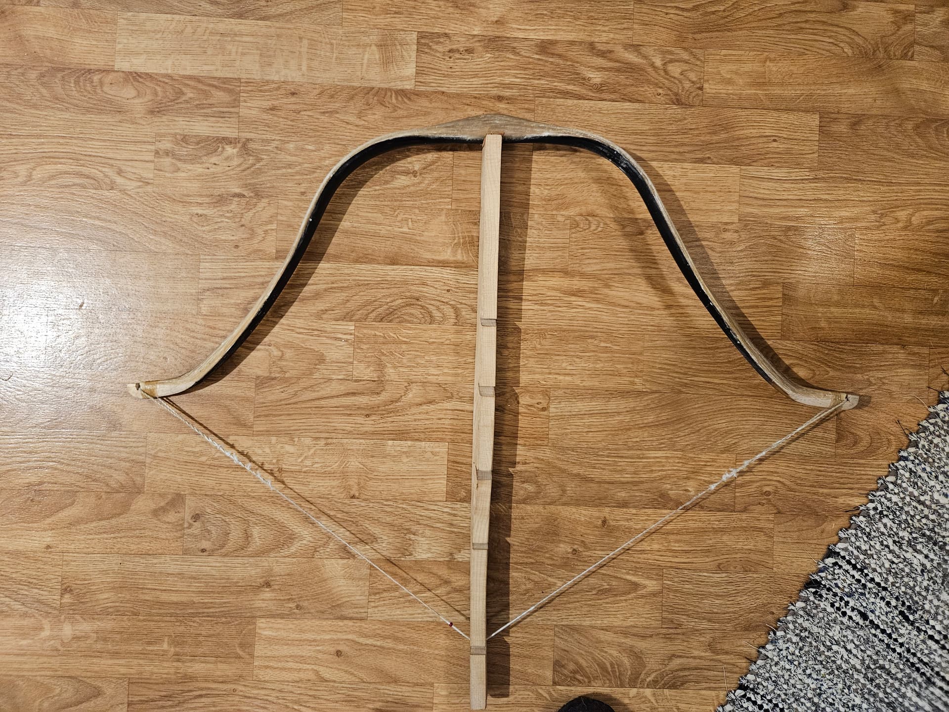

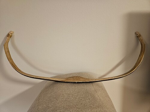

This one bow i showed earlier has been taken to 24" from belly. It shows the bow has way too long kasans but is holding crazy reflex. So it might be still fast, even though it looks a bit stupid.
This bow must finish somewhere at 105-120#.

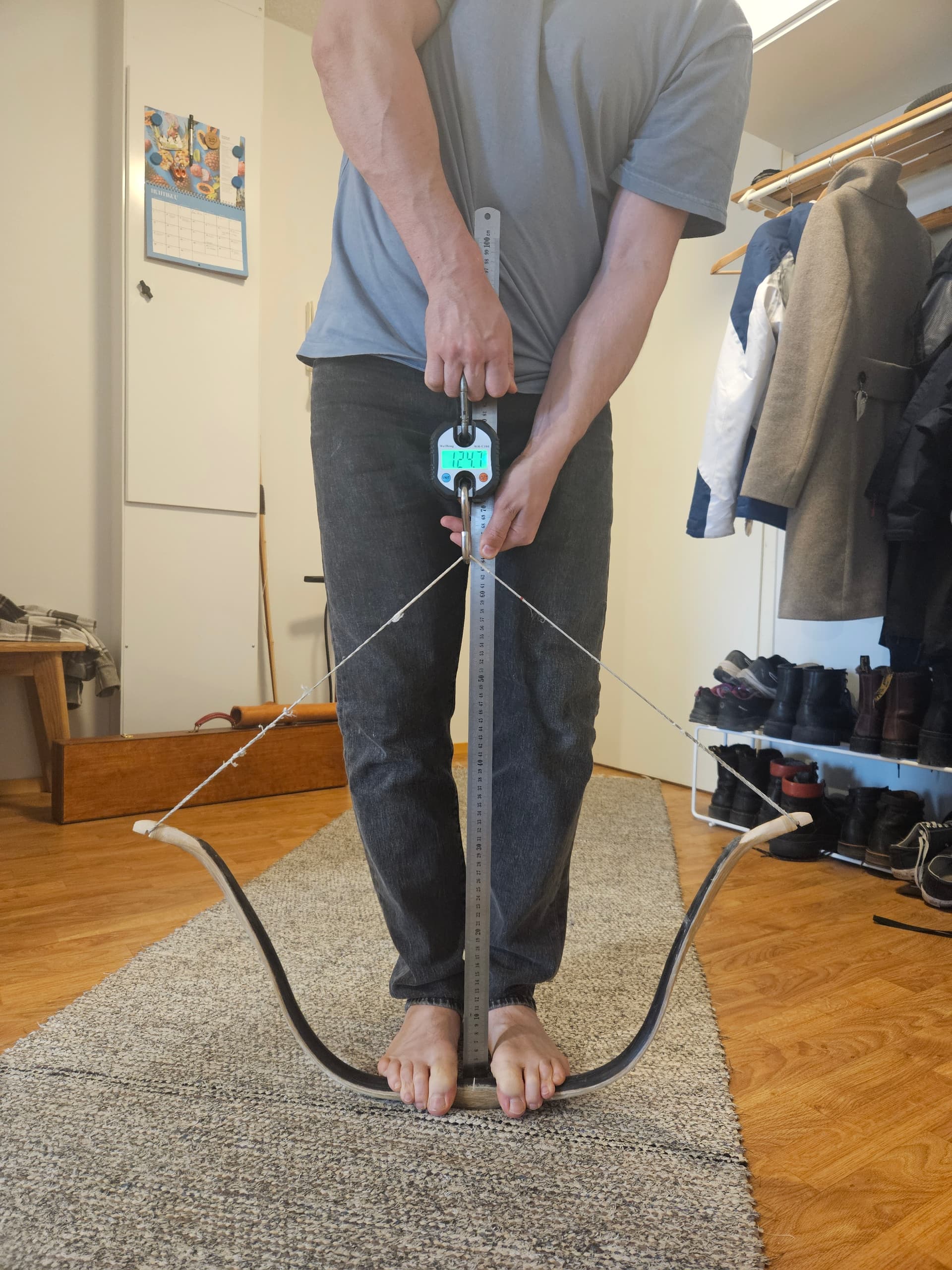

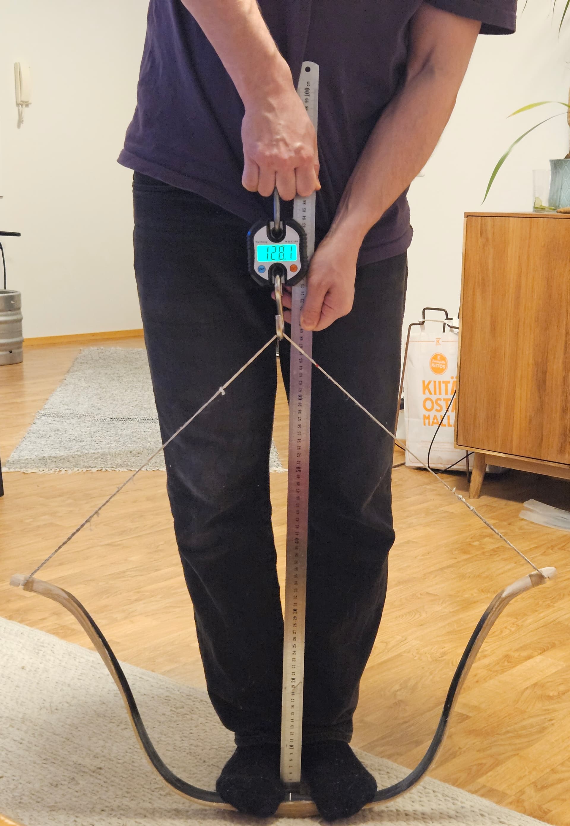

This #7 bow is pretty stout. ~130# @26" from belly. I really like it that it has stiiiiff handle, long bending sections and small amount of more length (112cm ntn)
I think this is the way i want my bows to be.

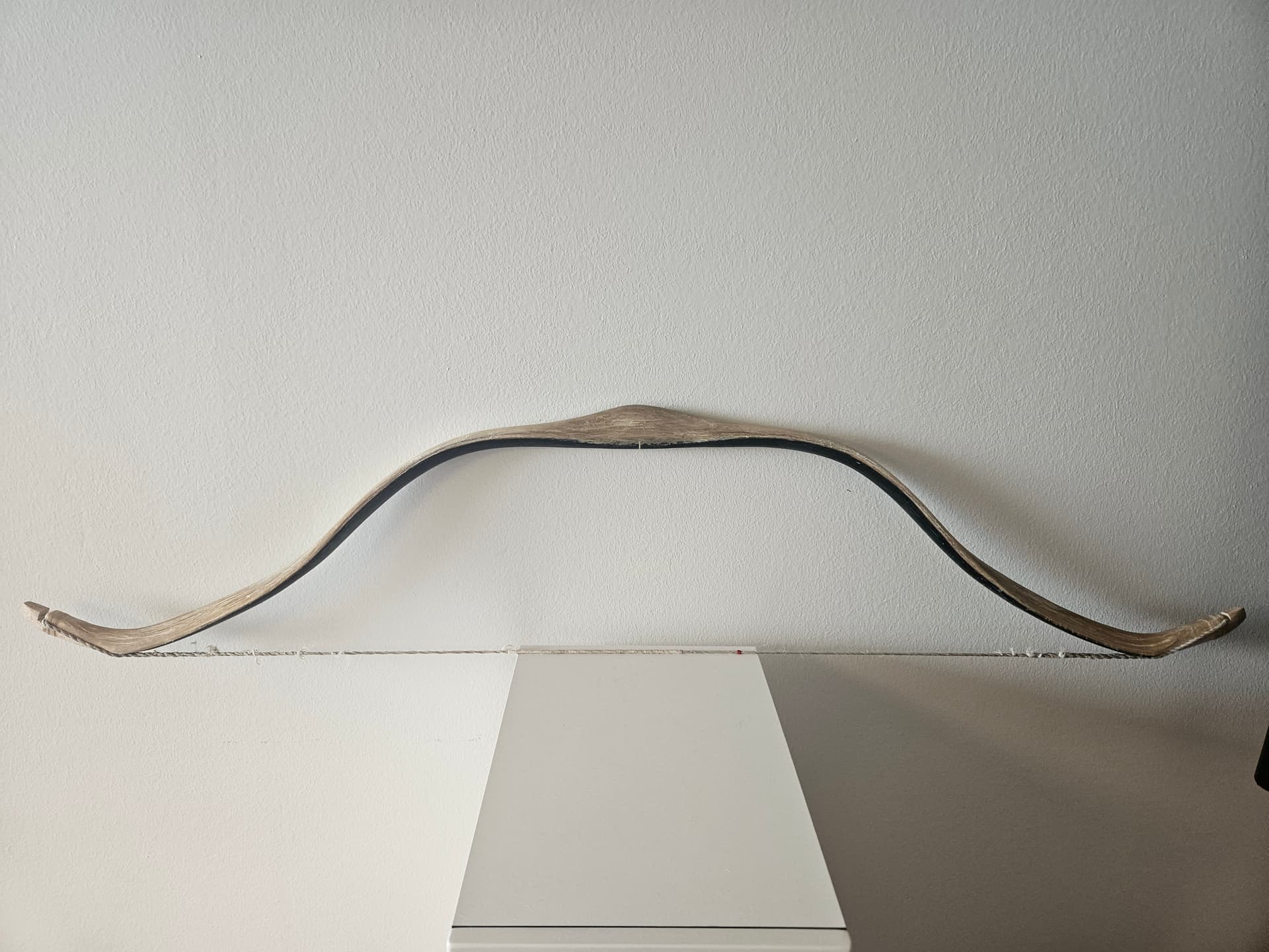

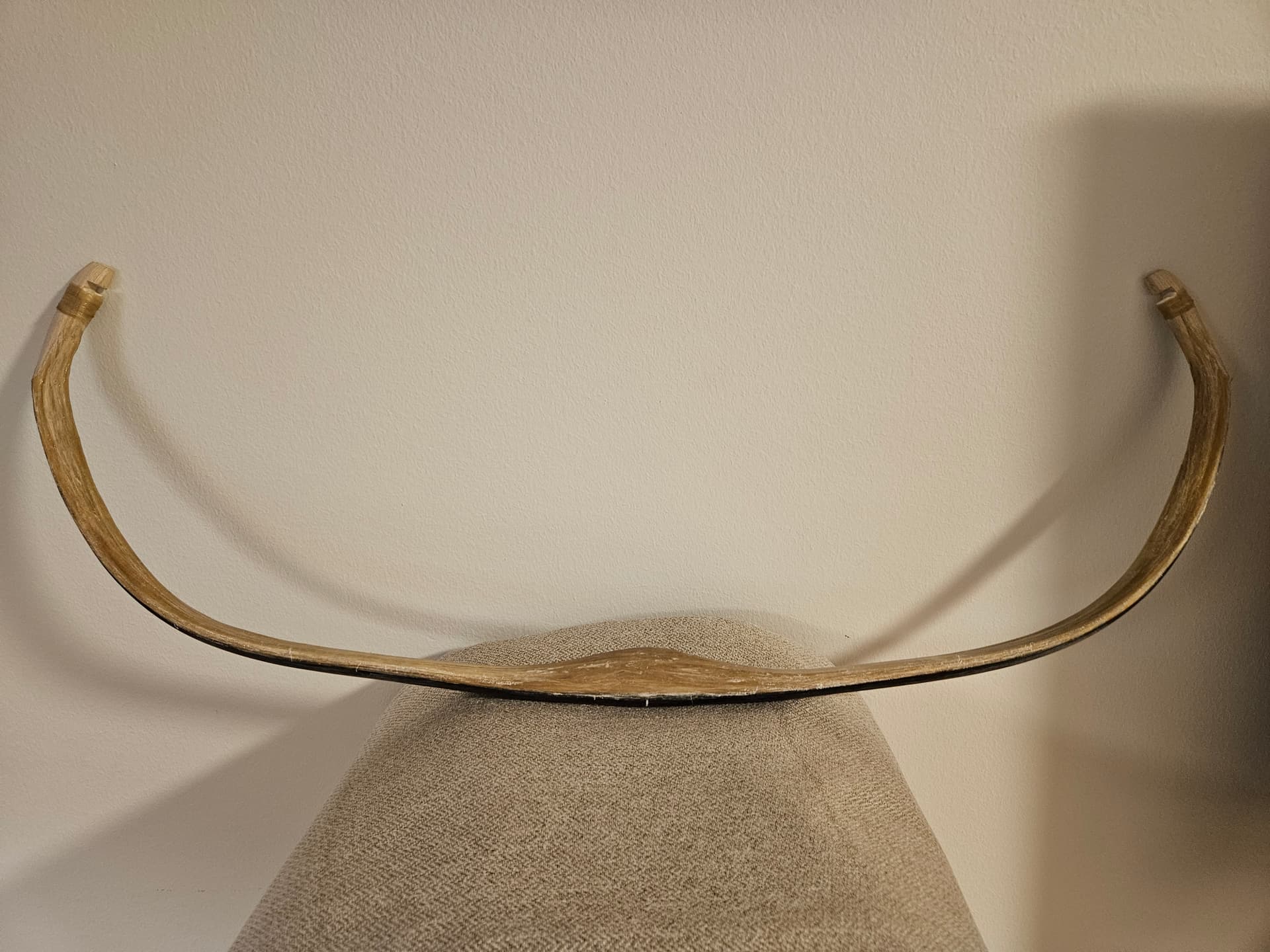

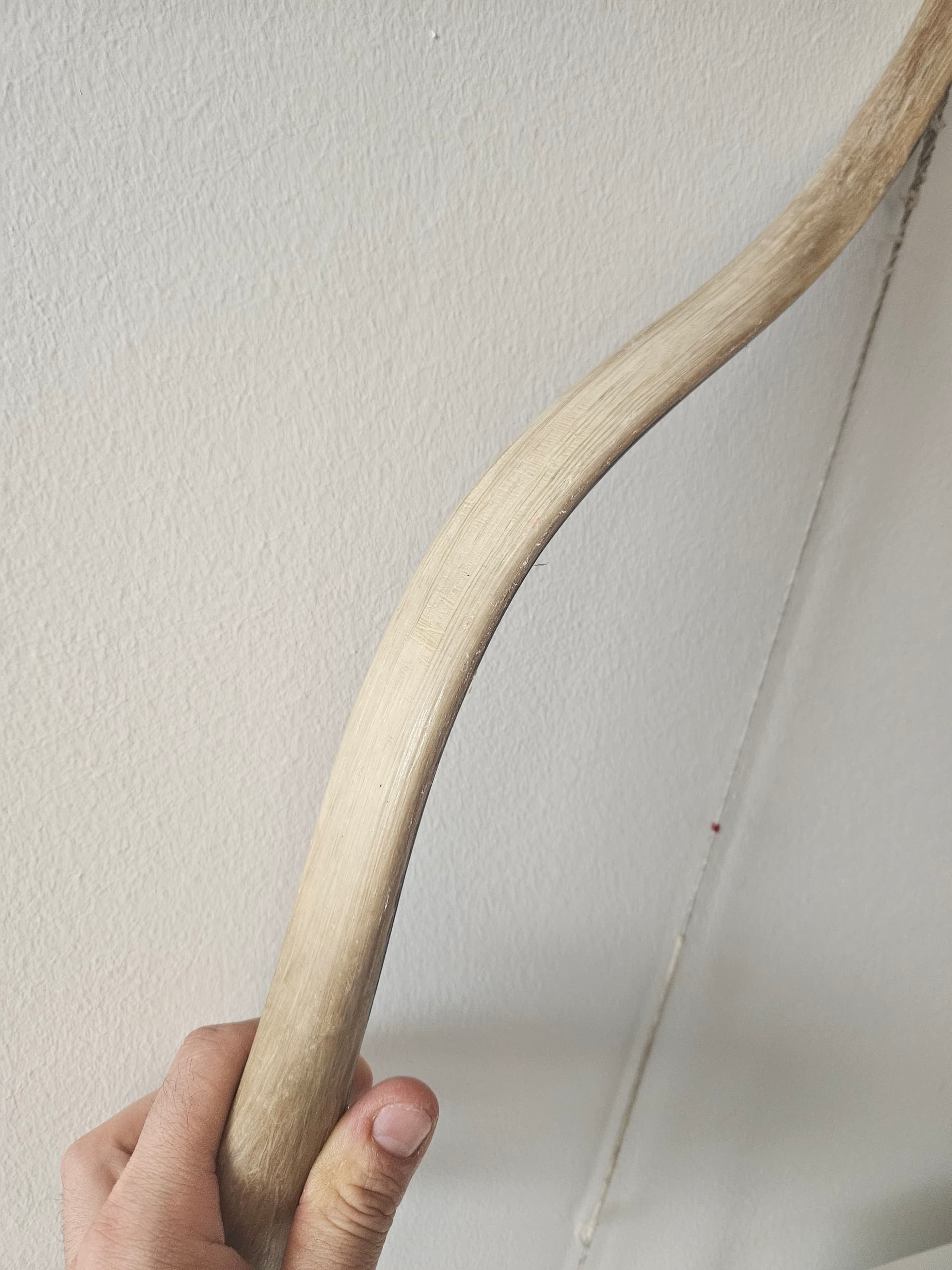

After brace, the reflex is gained pretty fast. Picture is 3 minutes after unbrace.

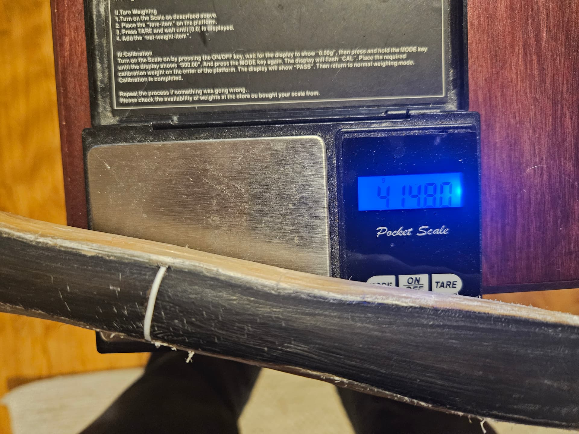

Mass is 414g.

This one is 110cm ntn. Now 125# at 24" from belly (25,5" from back). I will make it finish most likely at 130#. Mass 400g.

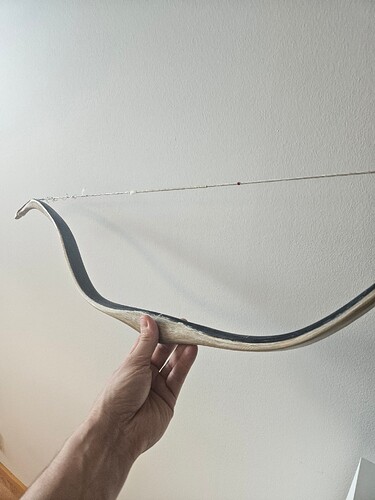

Here is a practice draw from 142# flightbow. A bit old picture, i can draw it fully now.
Looking awesome. My shoulders hurt just looking at this picture! I think my days of hoping to shoot a 100 lb bow are history
I agree awesome bow Jere.
Personally I would think that the bottom bow shown drawn would hold more reflex compared to the top bow shown with the longer handle drawn as it seems to look to have more length of working limb.But if any set is taken on inner limbs with lower bow shown that can hurt reflex a lot.
Anyhow it’s still an awesome bow Jere.
Thanks guys. Lots of training goes into it…!!
I should have mentioned that the 142# bow drawn here is a glassbow. Its for practice use only, since its a bit too heavy to control with tiny flight arrows.

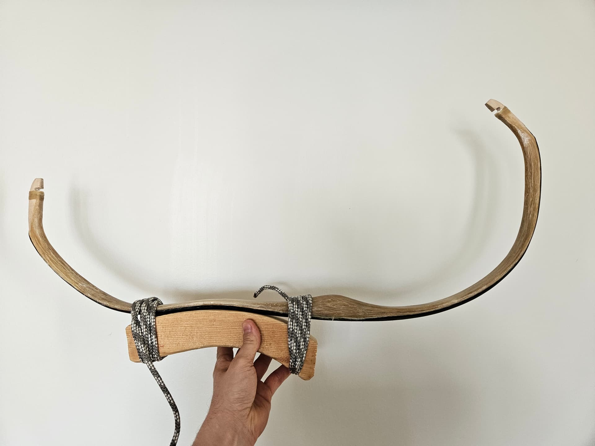

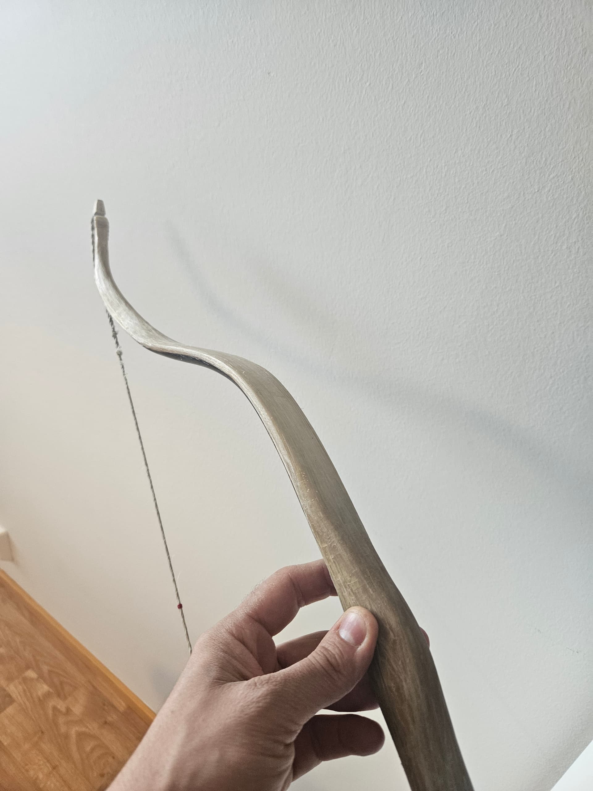

These two hornbows that i recently showed are a bit different from each other. Both have longer handle, but the latter (125# @24") has a bit more abrupt kasan angle of sorts. In a big picture they are tiny differences though - both will shoot arrow just fine.
Ed, you mentioned set near the handle. Its a thing i’ve started to pay attention in hornbows too and its one of the reasons i think these stiffer handle bows work better efficiency wise. These seem to keep better reflex. It is not new thing for me when it comes to woodbows and i favour more elliptical tiller with those also.
