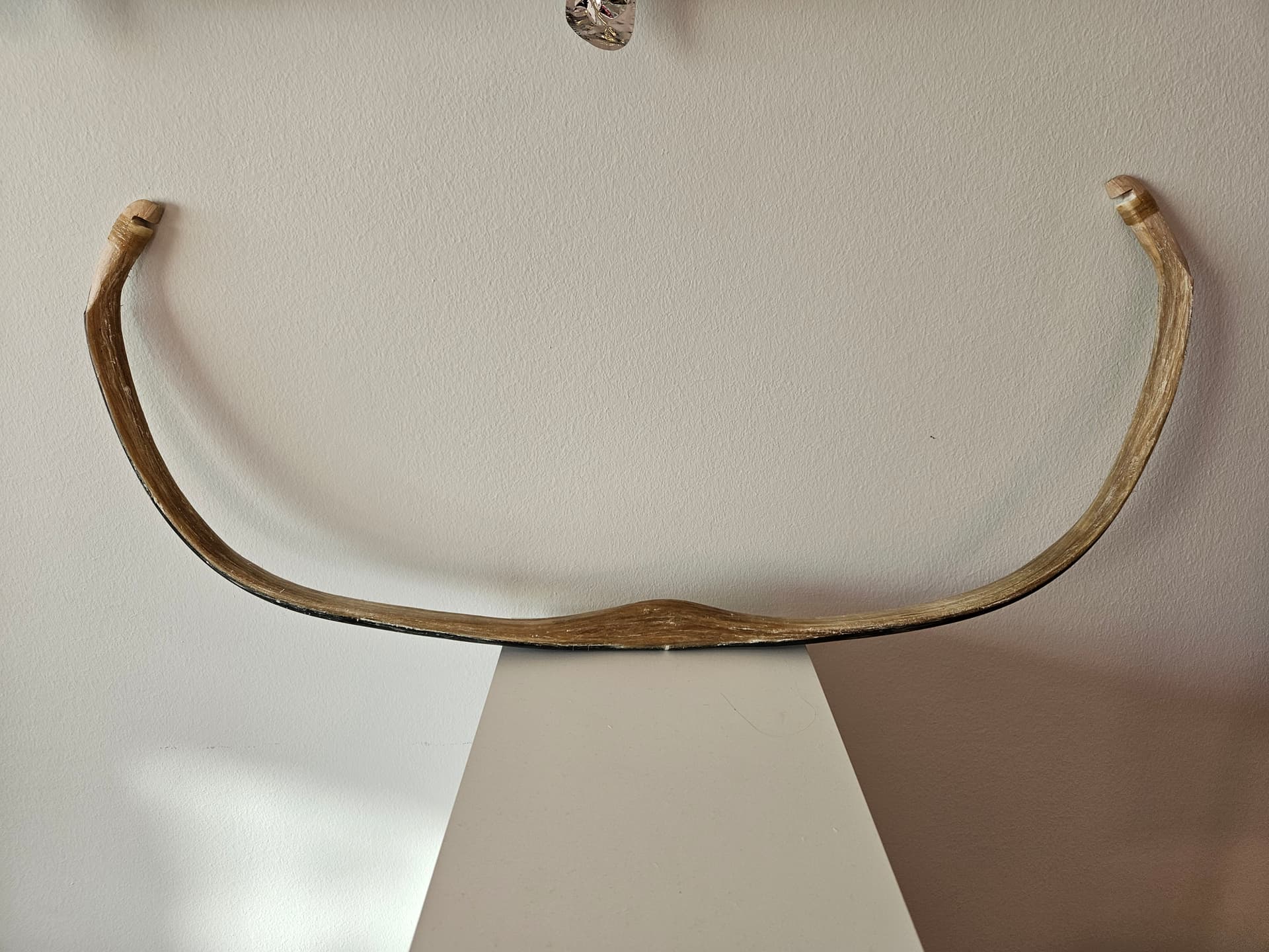

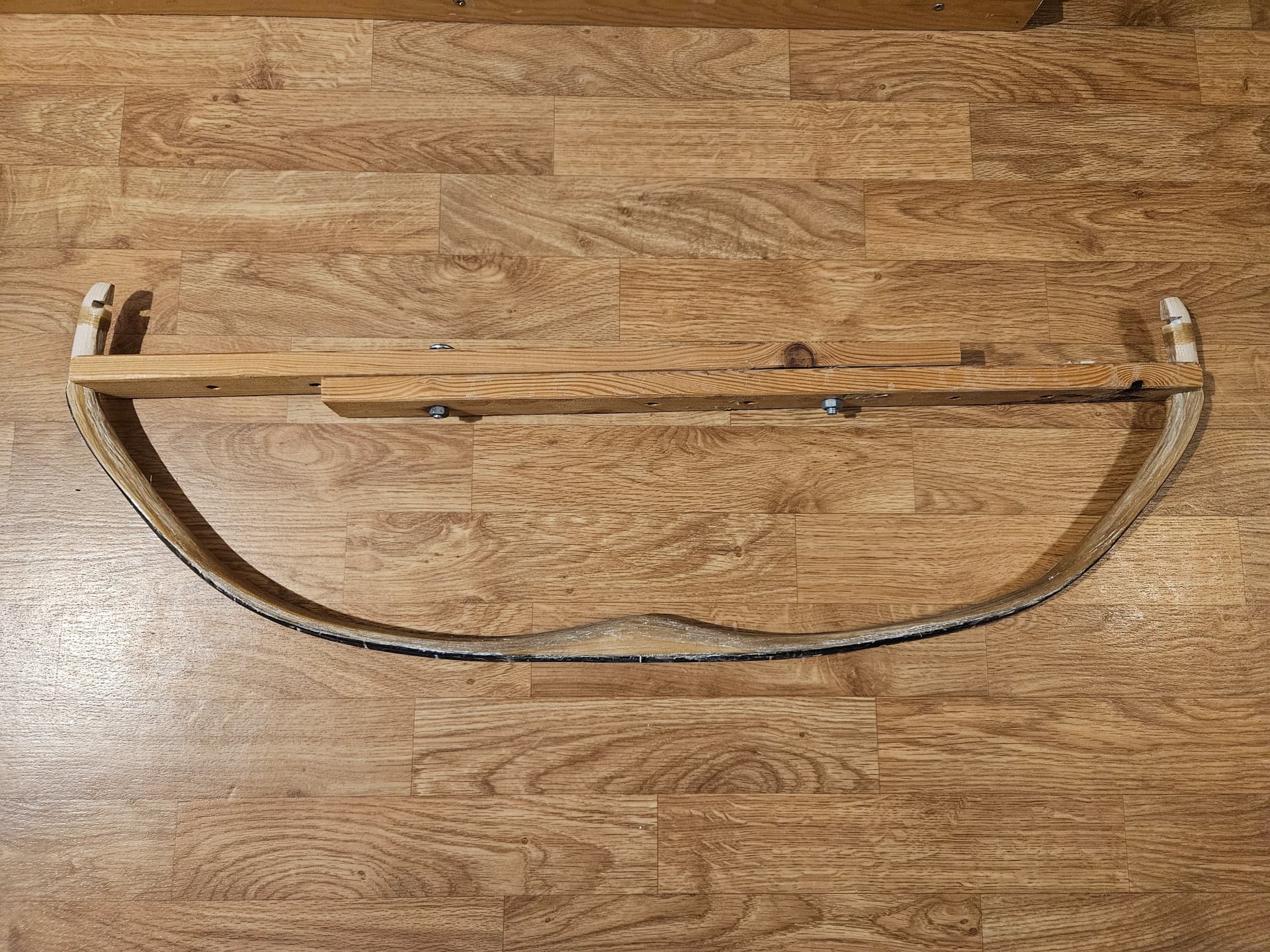

Old and new. This bow drawn here is 140# @26" (from belly).
This year i try to keep poundage lower from the get go, but at reasonable 110-125#. I think stressing these bows excessively from the start isn’t healthy for the core OR horn.

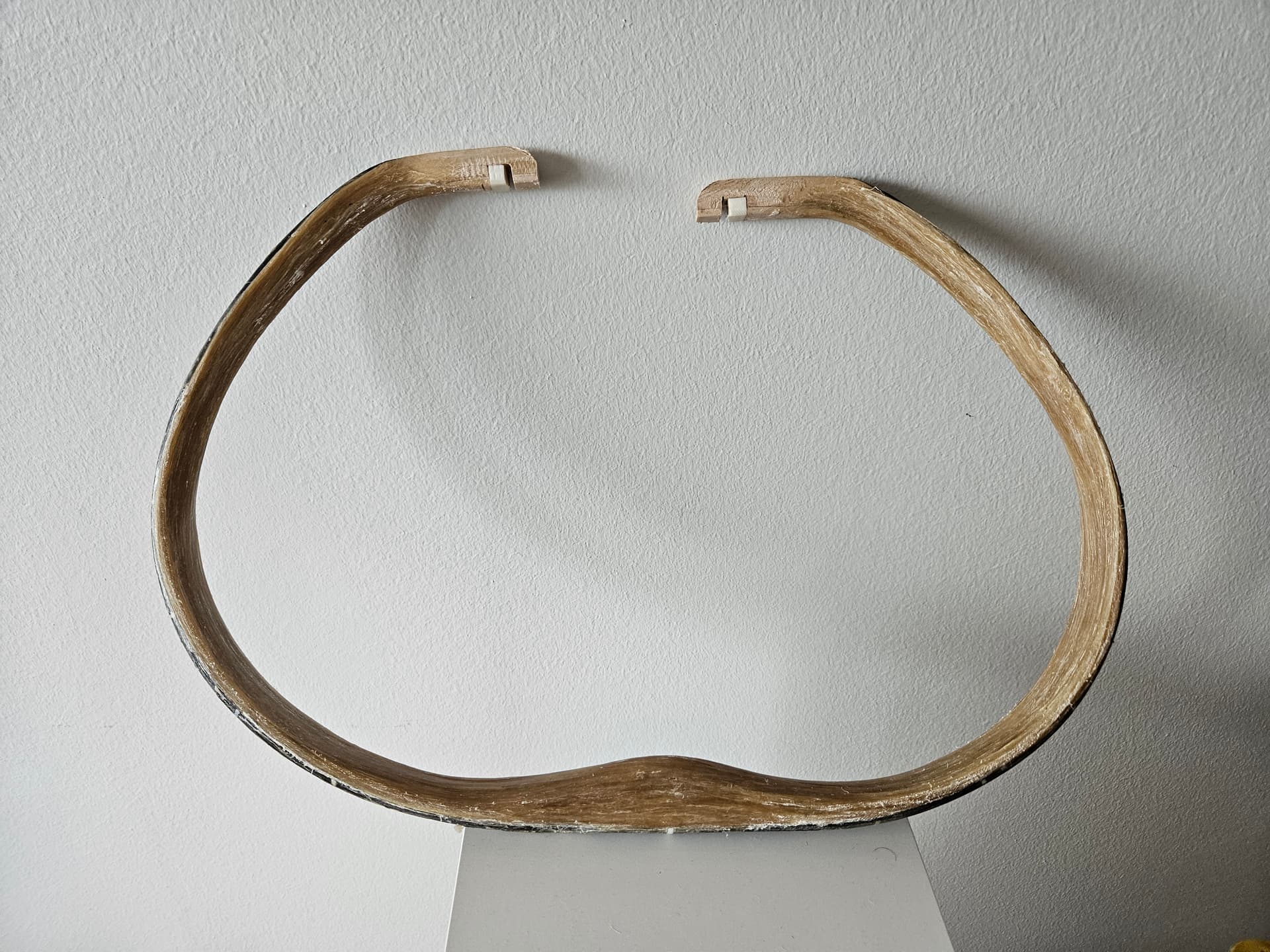

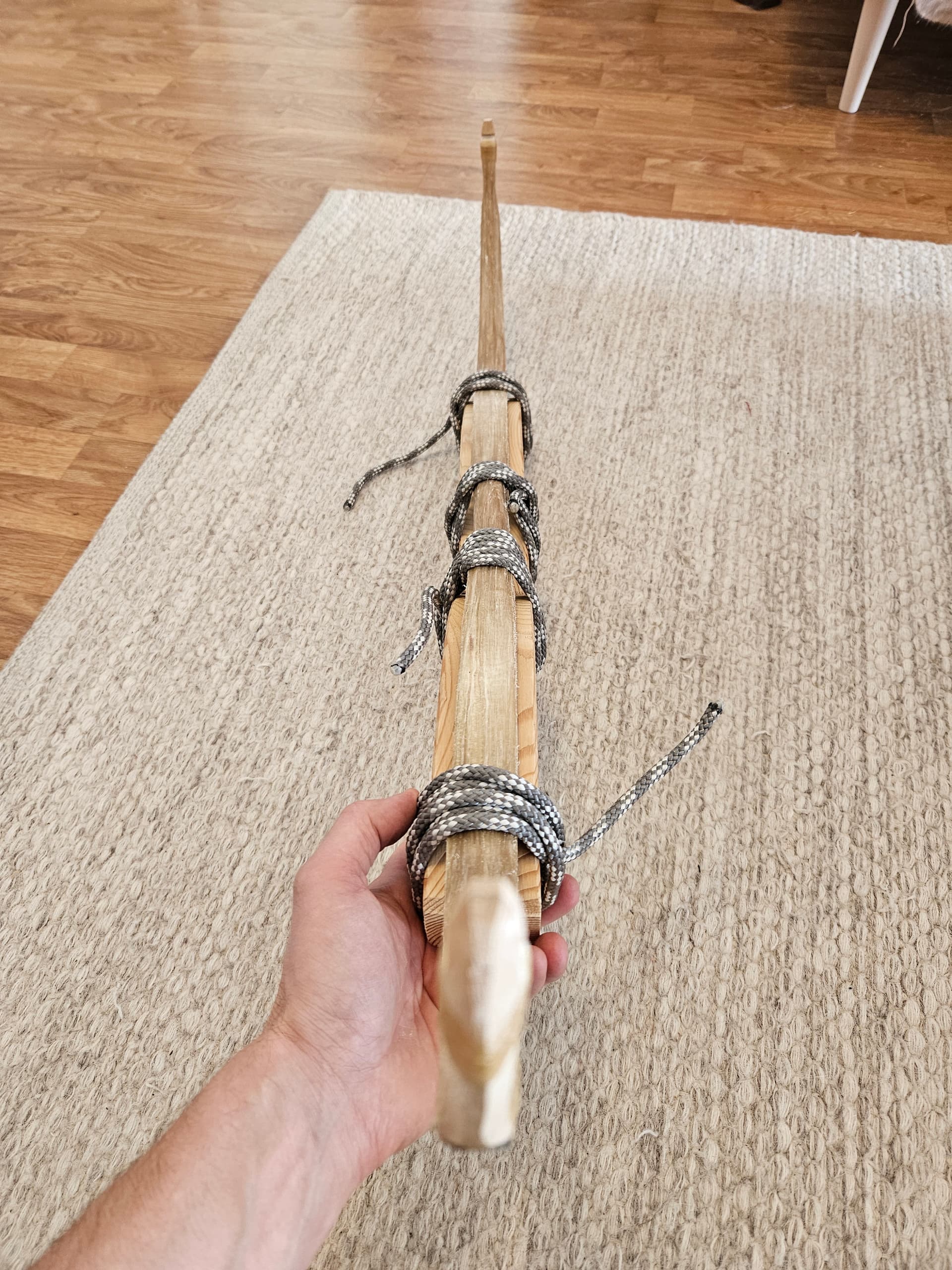

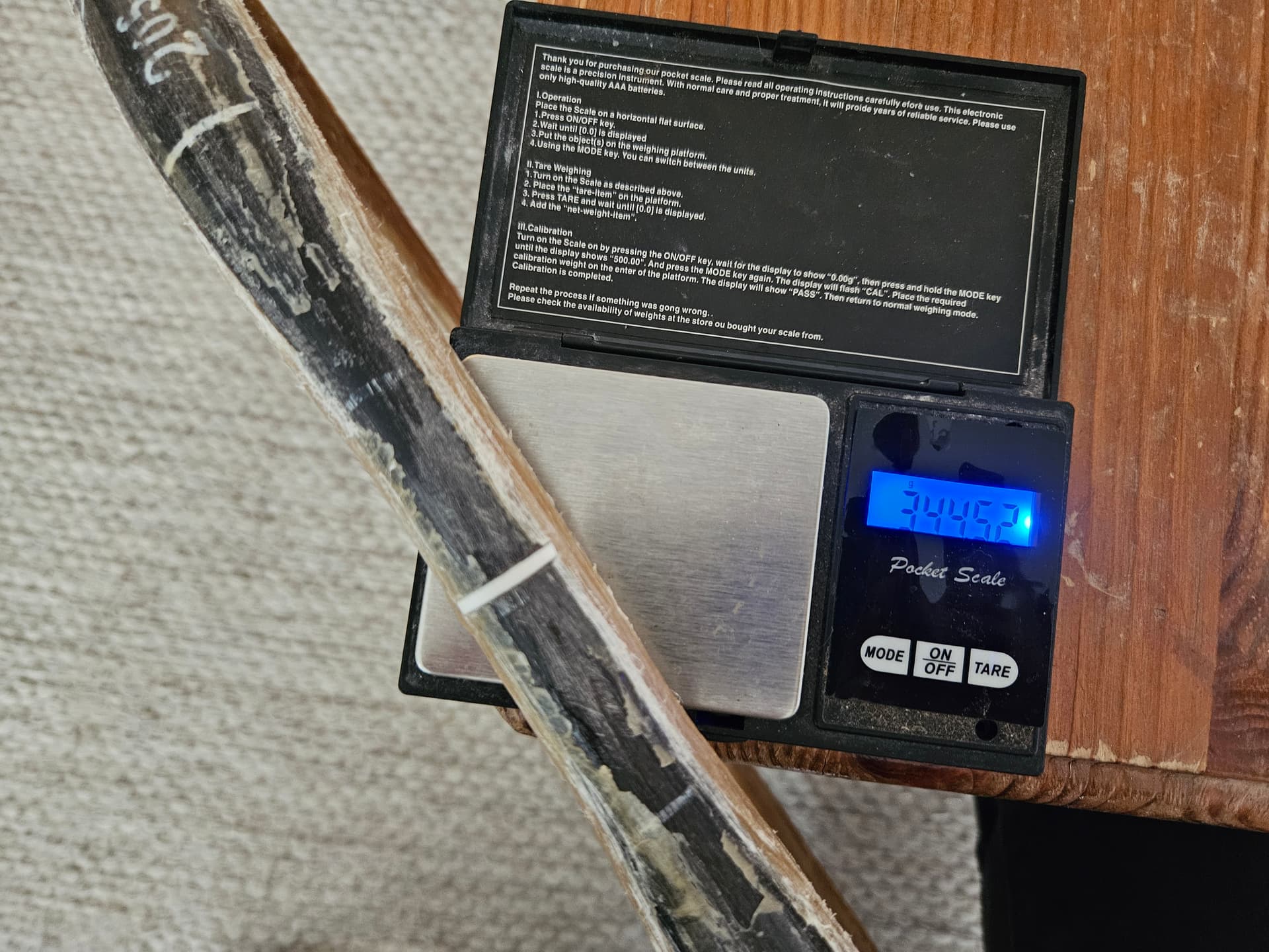

Here is the first candidate for opening. 108cm or 43" ntn, 344g and thinnest part of limb is 30x12,4mm. This should land at 100-120#. Its a bit hard to estimate since i feel sugar maple is much stiffer. Even though core wood shouldn’t effect poundage much, i still feel it does. Especially when belly horn gets thin.
Either way, if this bow finishes nicely, i will chrono it and shoot flight in the spring!

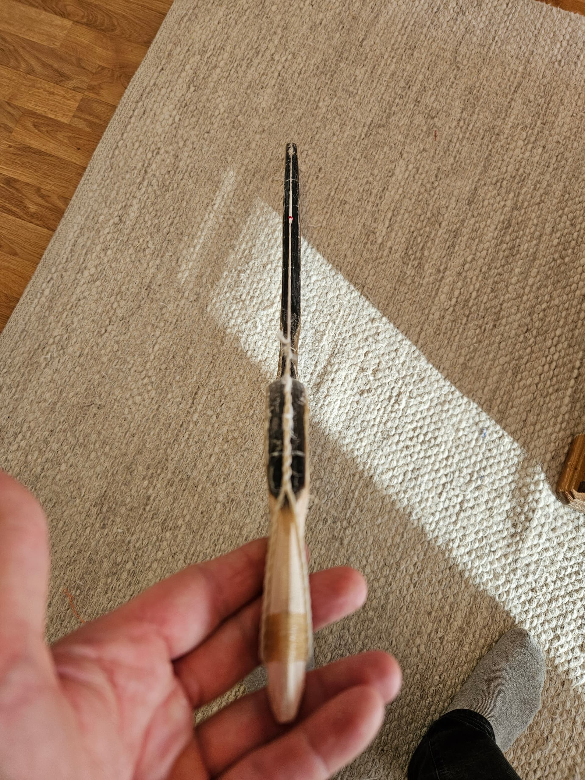

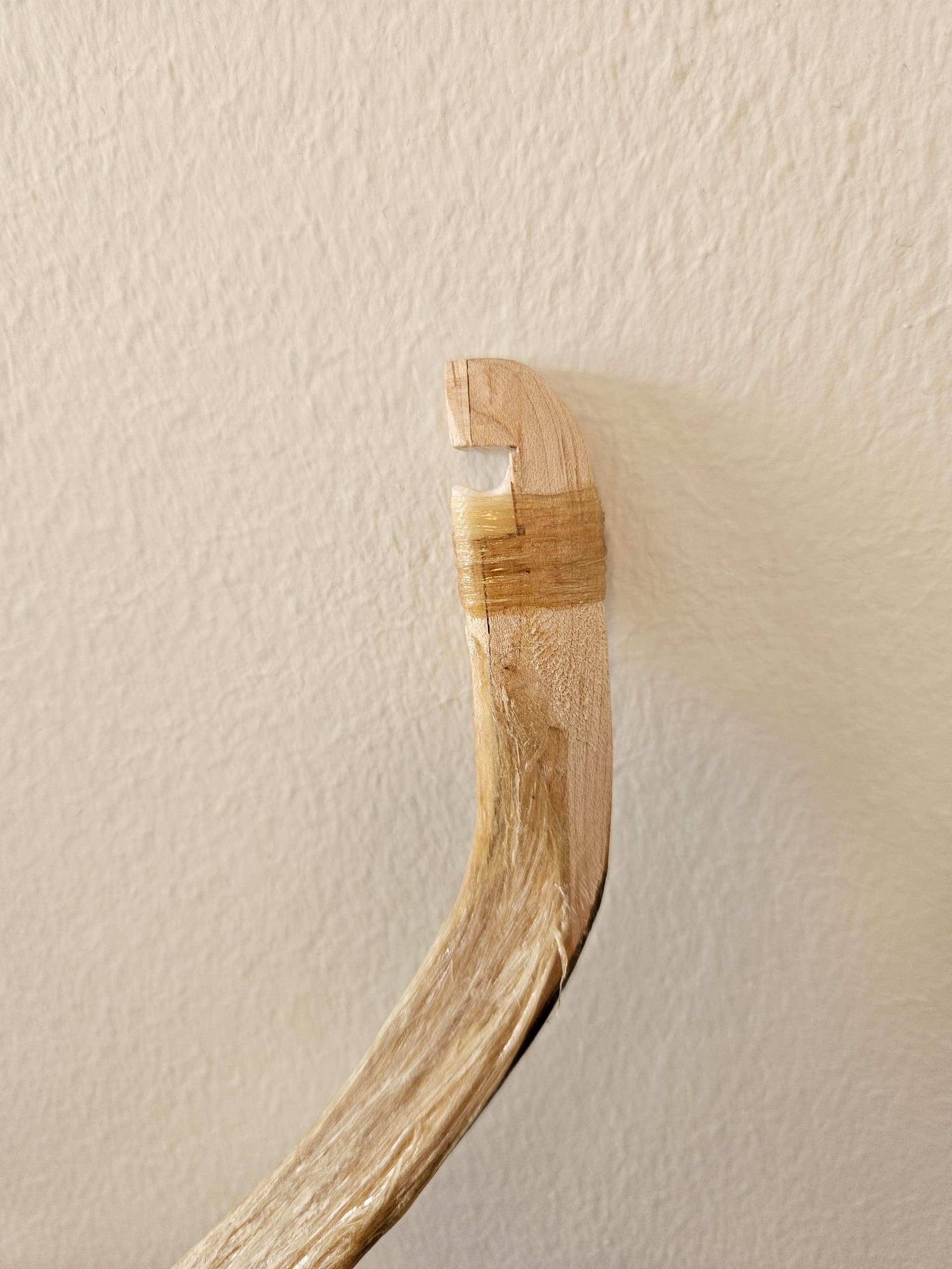

As you can see from the picture, it has bone nocks at place. Not fully formed nock groove yet. Bone is needed in order tips not to split.

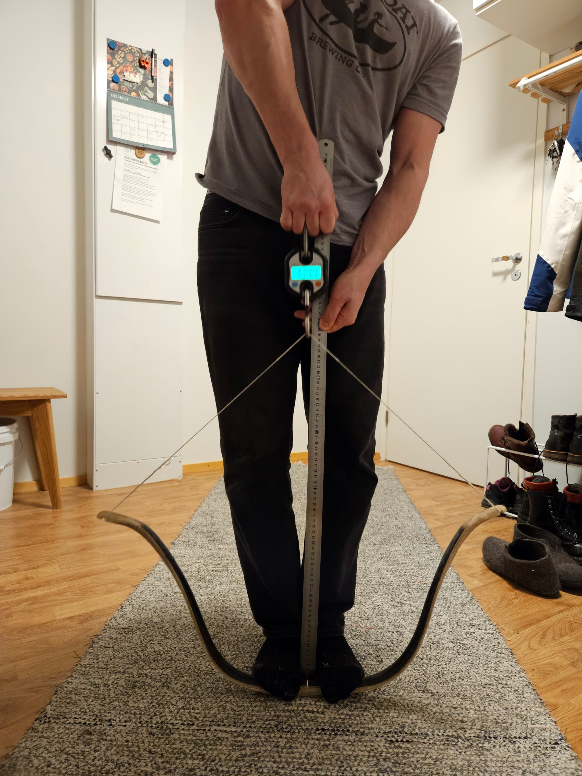

So looking at my little foot ruler here with mm measurements on the other side it is just shy 1/2" or .488" thick at your thinnest part and 1.18" wide.Thickest part is only 1.5 mm thicker maybe and how much wider?
That’s about what my 50# bows 58" long are at midlimb…ha ha.
That is a fairly wide range of poundage to shoot for compared to other bow making estimates,but is understandable.
Mass weight to draw poundage as Adam talks about in comparison I believe is where your bow will shine.You’ll have a hell of a christmas…ha ha.12.13 ounces putting out 120#'s or so.Look forward to the distance and chrono readings also.

Good idea or process of reinforcing those nocks.So when the poundage gets really high the sinew wrappings are’nt enough.A close up view of those nocks might be nice.

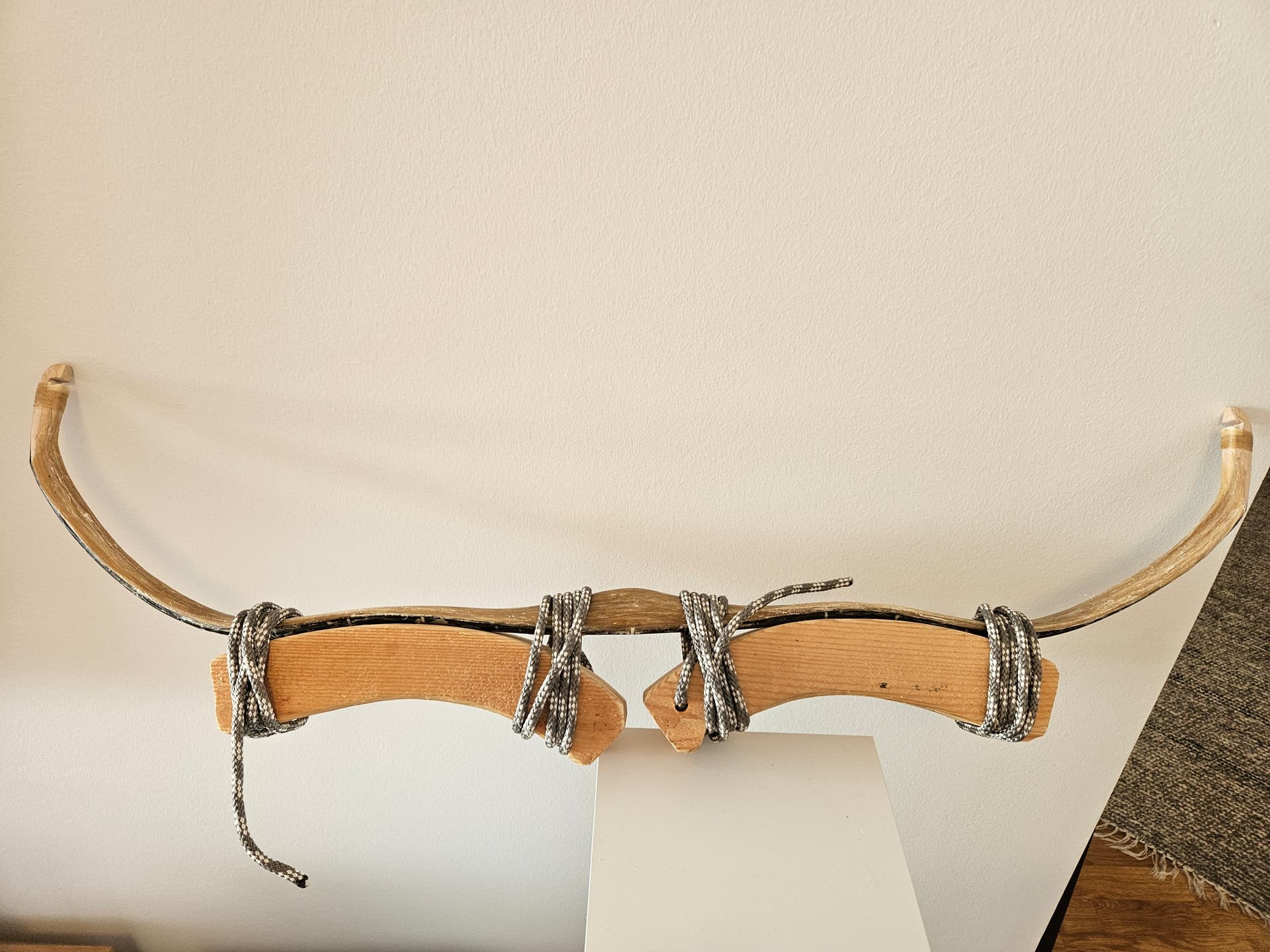

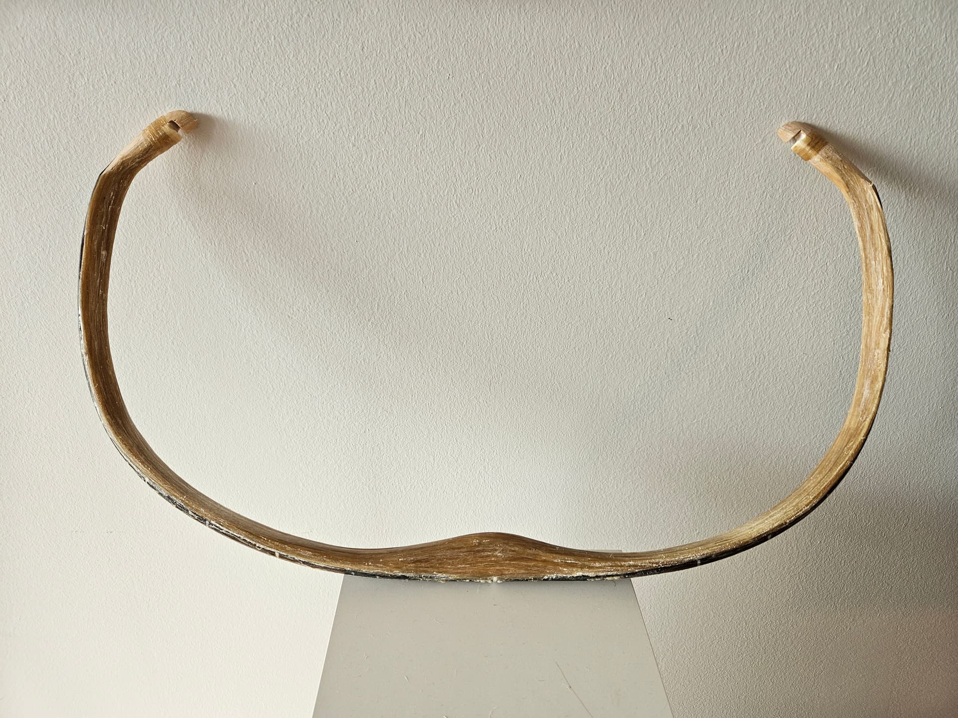

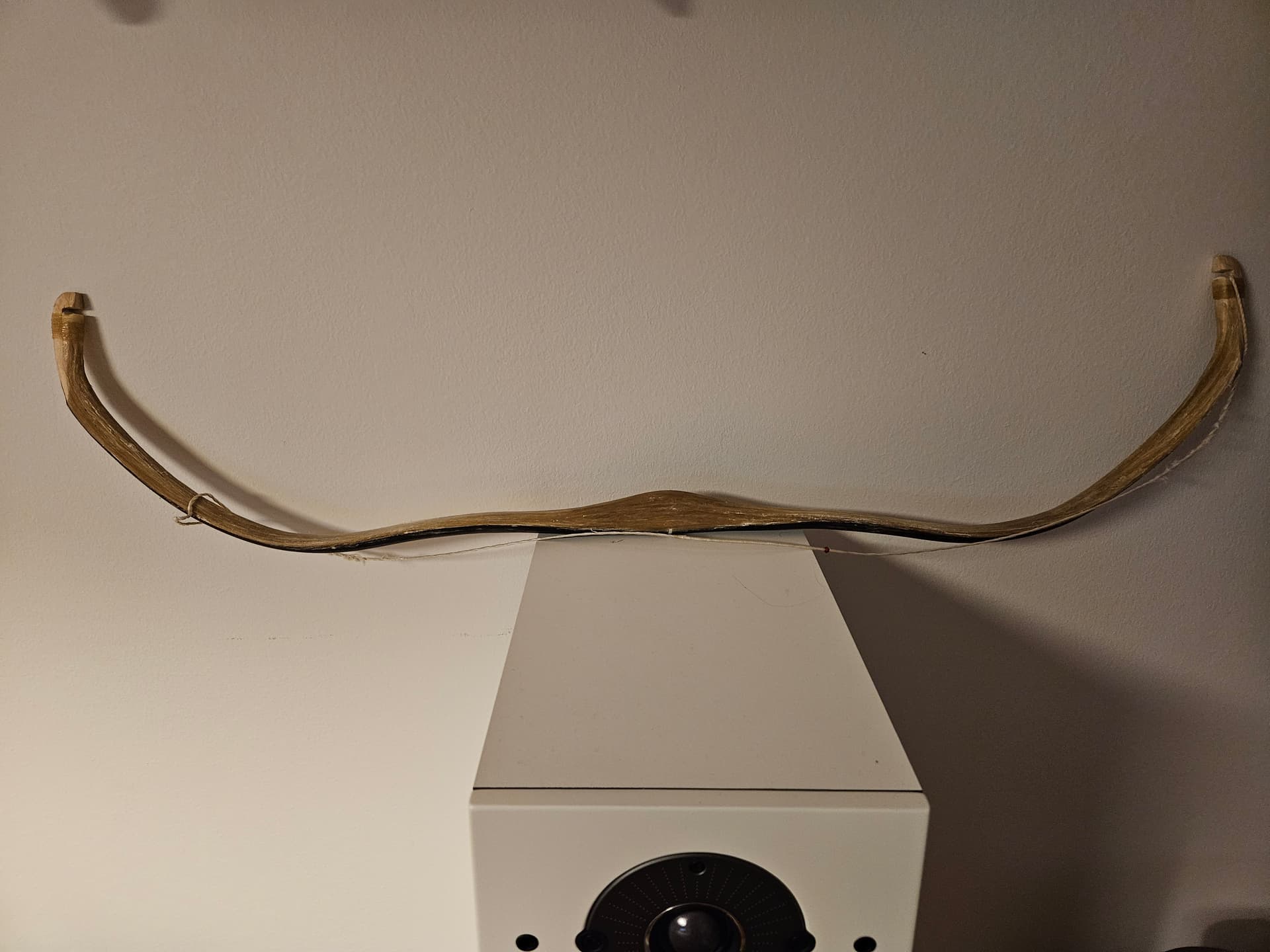

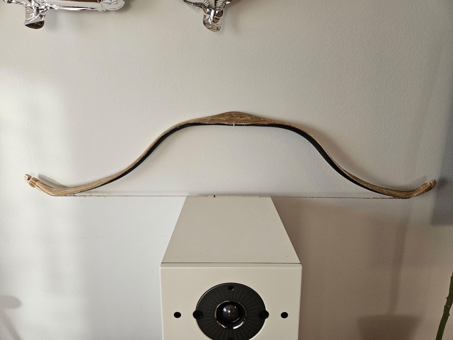

Here are some pictures of my new set of bows. It might dissapoint some with the short cure time but i really need to have good bows for may and i want to be in time. I think i will brace some of the bows, cauge the weight and decide which can i use in the competition. Goal is to not stress them too much yet.
These bows seem a lot better than anything i have shot before. Last set i semi-ruined with heating the limbs before using tepeliks. Thats a big no no, but i was a serious bow destroyer back then and i was scared. Well, one of the bow set a world record so…?
In any case, now the spring back is quite a lot better with no heat induced reflex!
Whatever bow i decide to shoot in Istanbul, i will heat condition it to have it more dry.
107cm bow, could end up 100-110. When conditioned a 120#?
This one is heavier, 110cm and maybe 120# now without conditioning.
Those look awesome so far. Lots of trial and error to get to that point.
There was another error! This is the 110cm bow.

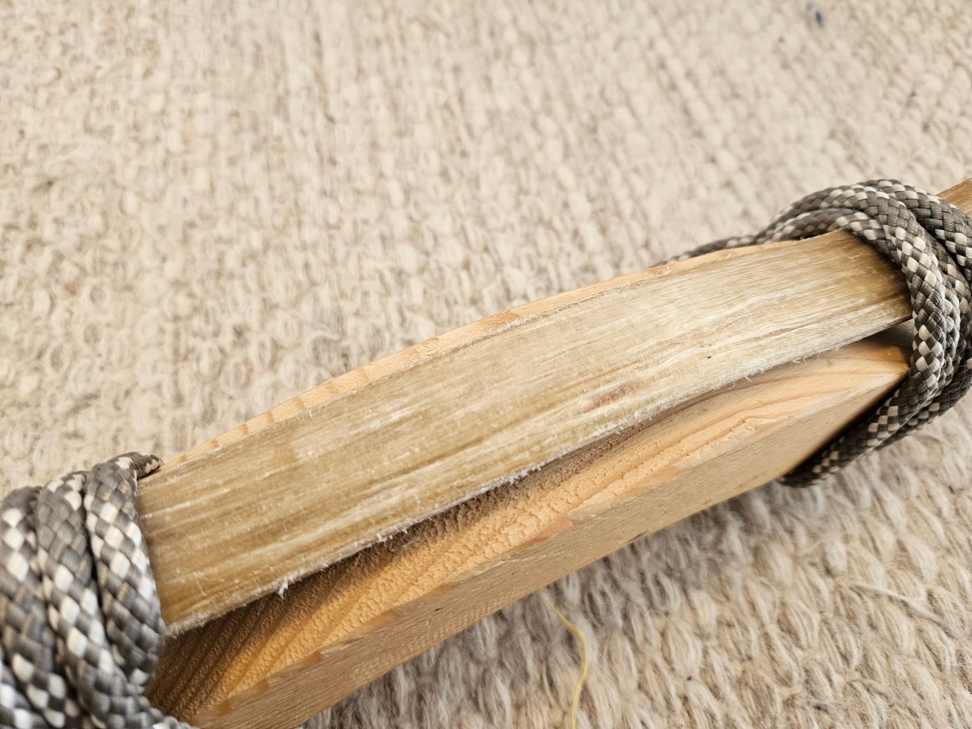

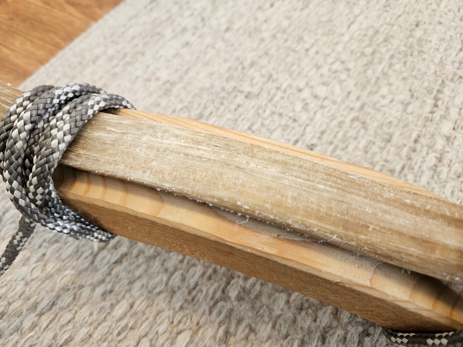

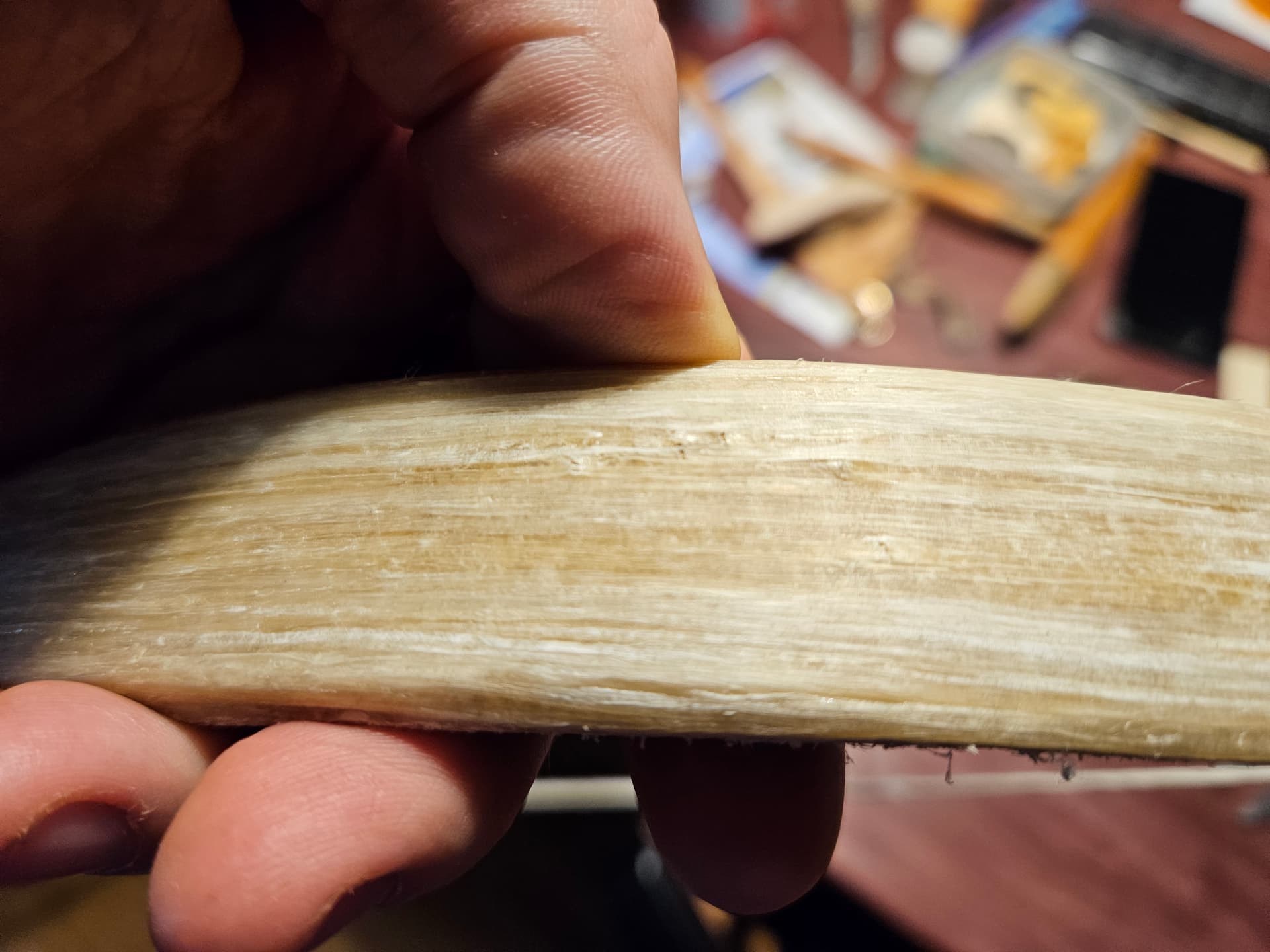

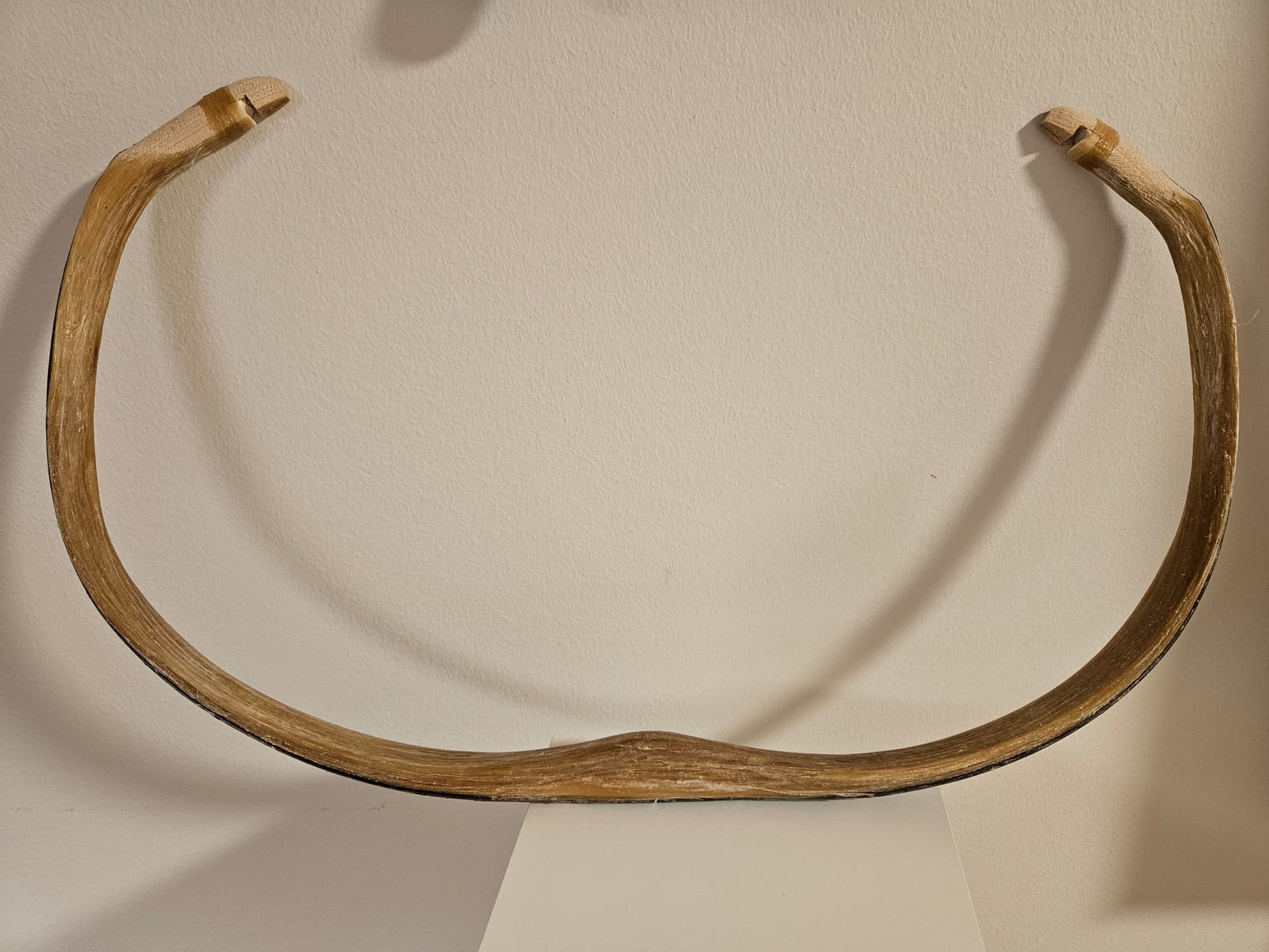

I tried a new method for sinew backing - applied a lot thicker layers. Mostly it was success, but on some places it made the layer too thick. Like 5-5,5mm thick sinew. So i had to scrape down in some places. Well this uncovered some air bubbles and then sinew on top of these air bubbles is working a lot… which then leads to sinew breaking under tension.
Here we have a little of sinew giving up. I need to apply a new layer here. I will rasp away 0,5mm and then sinew a fresh layer. It most often adds 0,7mm or so.
That’s a lot of sinew at 5 to 5.5mm.Maybe I misunderstood.Course you want the poundage though too and it might require that.
It’s hard to believe air could get in there the way you apply your sinew.Was the problem not pressing the sinew down well enough while applying the problem you think?Maybe not melding well between layers.
The sinew looks rather glue starved.
Flooding the area with very thinned out glue might help also.Then thicker glue for patching.Just spit balling here though.I’m sure you have your own thoughts on that.

You are right, I’m not really happy with the sinew job even to this day! I’ve had some problems with sourcing good sinew and tinkering with the process because of that. Now its getting better but this was a clear mistake. Its possible to trap air if surfaces are cold and/or too fast gel. I do press the air out but yeah. Sinew glue might be interesting in that sense because i would have some more time for the sinewing process.
Yes, 5mm+ meaning 0.200". Heavy bows, heavy sinew! Turkish did use heavy layers of sinew too. The bows become bulletproof with thick sinew.
I have managed to soak extra glue on some finished bows too. Just need to warm the surface and flood it with glue time after time. It works quite nicely and has fixed bows that would have otherwise had some few sinew strands sticking out. Quite versatile fix! And doesn’t break the schedule with long drying times since its only the surface you are playing with.

When using hide and sinew glue I try to make my work enviornment very warm.85 F. to slow the gell time in a room with a wood stove as most times I apply more than one layer at a time.I hav’nt used a hair dryer to reliquify anything yet,but that’s an option also.
Applying hot thin glue after drying a bit sometimes multiple times I feel is a good practice.I don’t like any white areas which mean its starved for glue there.
Using backstrap sinew sinewing bows has in the past shown to be whiteish when drying telling me it has’nt absorbed the glue very well.
