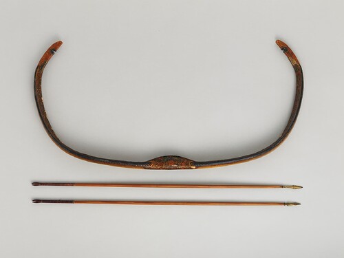

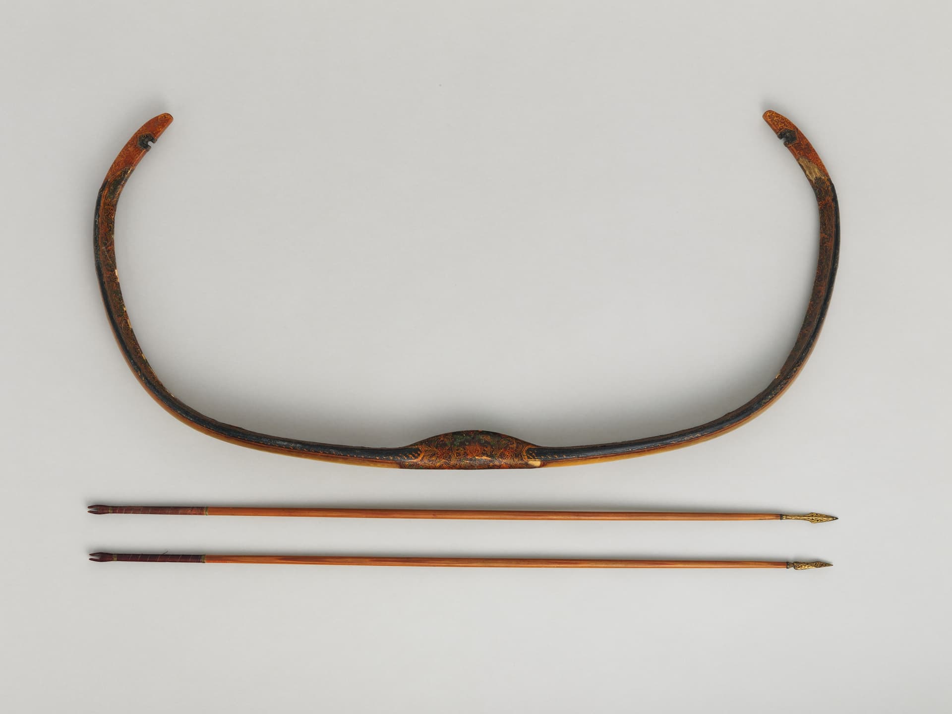

I recommend to look at some old bows from museums (online) and copy the form on paper. Then try to get the traced shape to 50-55cm like Marek mentions.
Here is a beautiful bow from Met museum.
What i can say is… you can overdo the bend and always open the curve by hand later. This bow here has quite excessive reflex. But core form is always going to be reflexed more than the shape of the bow in everyday use.
