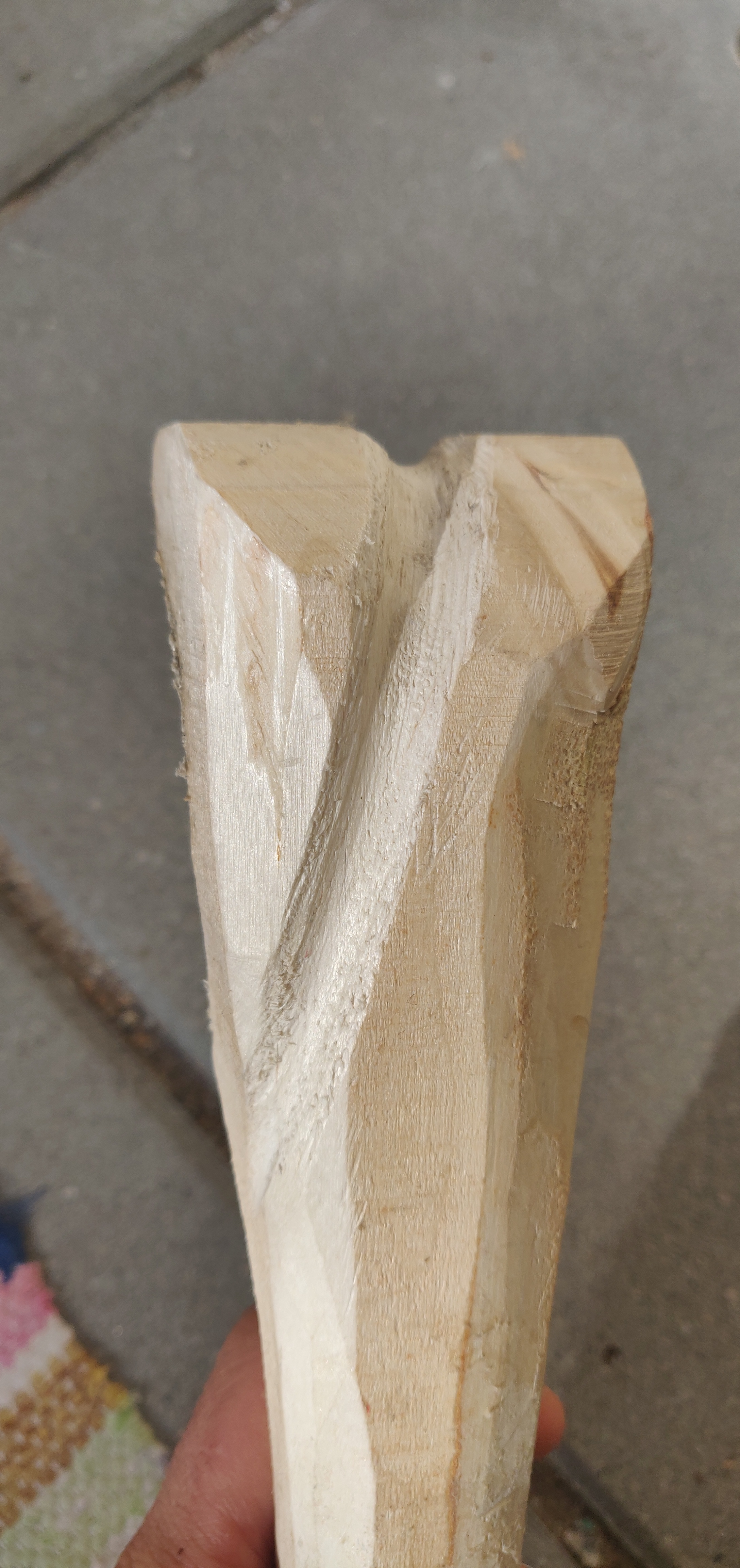

Need help with core
No problem. Here is my 2nd version of tencik. Works really nicely.
Originally i drilled two holes, but i actually only use the bottom one. Then with hand i adjust friction/tension. I recommend 10mm thick rope for it.

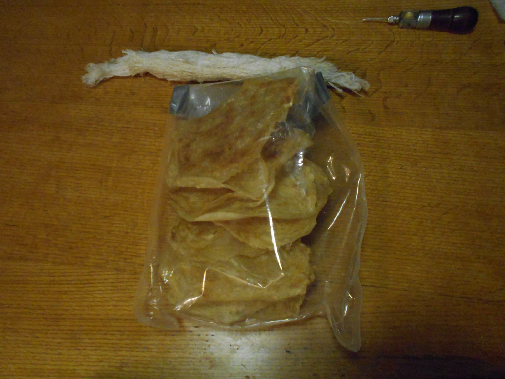

Damn! Even the fresh bladders are expensive. There are some alternatives also, was it some “croaker”? Don’t remember fully.
Yes I’ve made some yellow croaker glue.It lives up to it’s name as gelling slower I’ll vouch for that.It is not as expensive either I’m sure.It took a lot longer to gell up to cut into squares to dry.
I remember at that time I was collecting the swim bladder lungs from any large catfish I could get also…ha ha.
It’s been so long I can’t remember where I got it from though.It’s for sale though on ebay and amazon.
People like to use it in their soup also.
To make it pulverize the hell out of it before par boiling it.That’ll create more surface area to break down better.I can’t vouch for how good of glue it is though as I’ve always gotten good enough results with no failures using good first pourings of hide and sinew glue.

I think it was yellow croaker. Jason Beever was praising it. But maybe other varieties work too?
I wonder if we would have some fish here in Finland too for this… Sounds like tedious work anyway hah. I’ve heard no one processing those bladders for sale though.
I’ve heard it’s also a good glue. There is a number of links on eBay sellers in china that sell the dried croaker bladders for tea infusion. I imagine it’s the same stuff used for croaker glue. I’ve heard that it’s not quite as good as the sturgeon glue. My experience with the sturgeon bladder glue is that it’s noted open working time and high strength yet flexibility. One would have to evaluate if it’s worth the effort in getting it. I’ve made a few batches of this glue and this last batch I was super careful in my temps when rendering down to ensure I didn’t go over 60degrees. Basically just hot enough to put your hand in still. I have done some crude tests with my glue compared to other sinew and hide glues. The sturgeon glue is more flexible before it breaks or cracks. I took drops of liquified hide, sinew, glue of my own as well as purchased versions compared with the sturgeon glue and I noticed the flexibility difference. Each dried patch/drop was similar in thickness when dried. The hide glues were brittle and broke right away after bending once. The sinew glue was slightly less brittle but also snapped. Sturgeon glue took 4 bends back and forth before cracking and breaking. A crude little test but it gives us some insight on what this may be doing to help better flex and move with the horn belly glue ups. Yet still give strong adhesion. We might hear less cracking when bows are drawn. Perhaps?
