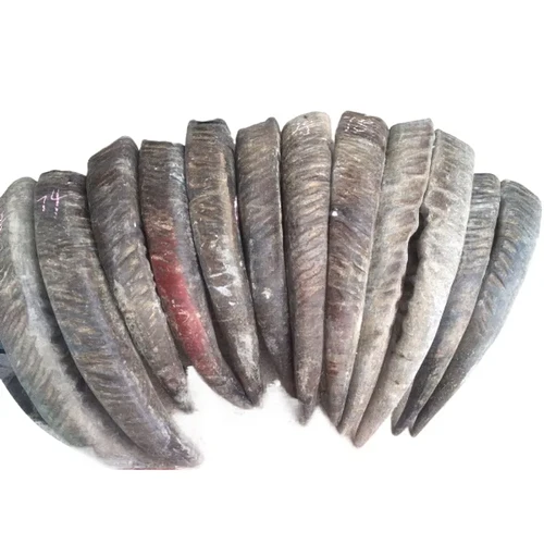

Ya I have had mixed results from these guys. I’ve ordered a couple times from them now and some were great and other not so great. Some had lots of inclusion in them and strange grain orientation too. Be sure not to bend them until you clean them up a bit and work them down to closer to desired thickness. Also don’t bend them in cold workshop. I’ve snapped a few this way! They can be brittle when dry and cold. My latest batch from them seemed little better but I just wonder where others are getting theirs.
You might try Atlantic Coral Enterprise. They sell whole horn.
Ya they don’t do international shipping unfortunately

after some research I have found this listing from AliExpress:
Although I have not purchased from them.

I wouldnt buy horn like that from unknown seller. Seller might not know what is good horn to use for bows. You will most likely get it better price anyway from specific supplier.
Try Nick Nguyen in facebook or just email him: pufacraft@gmail.com
Also in instagram https://www.instagram.com/pufa_craft/
I buy all my horn from him.
