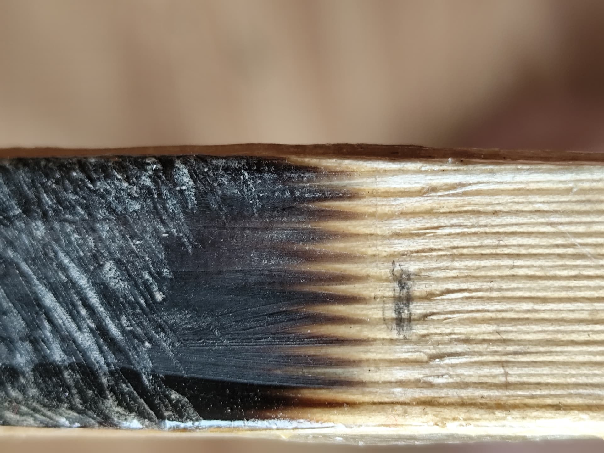

I had a little bit of trouble with applying layers of glue to the horn, there was always a void at the bottom of the groove caused by shrinkage of the glue, I rounded the grooves more, the humidity was about 80%, I think I no longer have this problem but I’m still not 100% sure of my horn-core connection. recently I glued the horns to 3 Turkish bows, now I’m applying layers to the Korean with smaller grooves and still a little bit of gluing v-splice connections
bad gluing
good bonding grooves nicely filled only photo taken in bad light

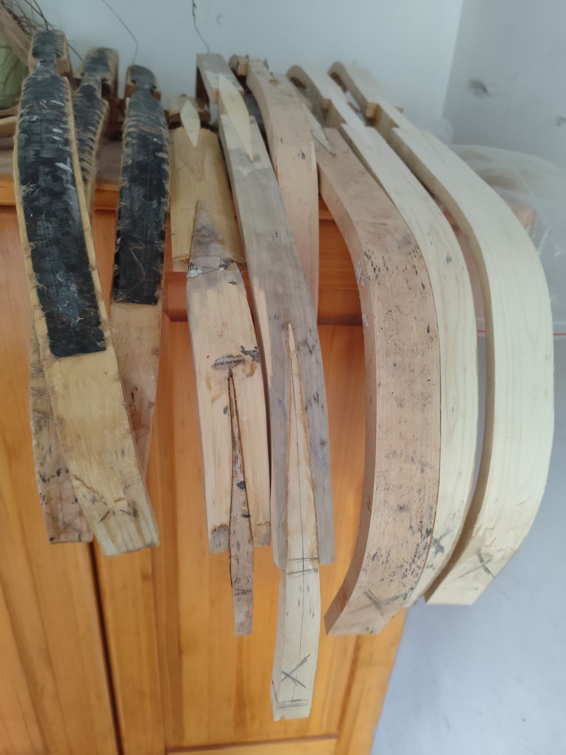

I glued six cores: 3 target Turkish, flight Turkish, almost Crimean Tatar (the shape and length are not entirely correct) and a Mughal which probably has a bamboo sal that is too short
Too short a section of bamboo

I took pictures of the transition of the horn into the wood and one side looks nice and the other bad but maybe if the horn falls off I will be able to glue it better if the core is not damaged
