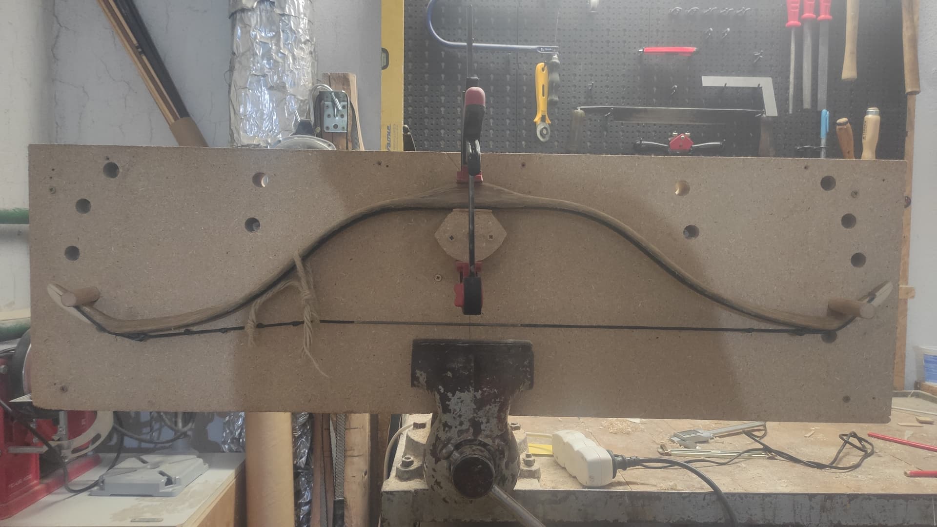

The right limb is already by 1mm thinner but it is still too stiff. Is this common or I used wrong pair of horns ? I hope I will get at least 60 pound bow from this. Left limb is 13mm and right 12.1mm.
Ouch. It could well be that the core is broken right from the grip. Something i have plenty of experience lately…
But don’t lose hope, especially if you did taper the core properly. Maybe horn on the right limb was more reflexed in the grip fade area.
In general, this place should have quite a lot of sinew, since the forces are enormous. This is what i have learned from old bows and other experienced bowyers. Extra sinew never hurts in the grip area.
What does it look like when unbraced? @Matthias is not afraid of broken cores! If sinew backing is good, you will have a shooting bow anyway.

This is the shape after tillering.
Top limb is weaker.
Yes bottom limb has more reflex in grip/sal area and I’ve tried to reduced it with heat but it didn’t help.
Grip/sal transition on core is triangular and edges are filled with 4-5mm sinew layer.
Unbraced pic looks better. Make it work! ![]()

Marek - I would like know, in your first two photos, what is that panel called to which the bow is clamped? Would you please describe it a bit and how you use it? Thanks
It’s a peg board. I made it because the bow was too stiff and impossible to string in the beginning. You can use it also for tillering.
You secure one limb and bend the other with both hands. And then the opposite until you reach the bottom of the board.
How thick is it? Made of plywood? Thanks.
It’s made of 3 mdf boards 18mm thick.
